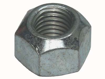

I would recommend replacing those torque converter nuts. The correct nut to use has a small pinch that distorts its shape. This is done intentionally to prevent it from backing out under stress & vibration. There is a special tool which is made by Sunex for removing the 12MM 12 point bolts. I have a product review on it: http://www.explorerforum.com/reviewpost/showproduct.php/product/458/cat/all
I hadnt thought about that but, Ill at least put some permatex on those nuts maybe I can strike them w/ cold chisel first too. I'm going to have to replace at the very least, one, so I'll pick up a handful at Home Depot. I guess that is why those studs are slightly tapered, to accommodate the "ding"....I commented on the 12 pt "woble" too, some may find my comments humorous. You guys are such a great help, what the hell did we do before the internet ?
