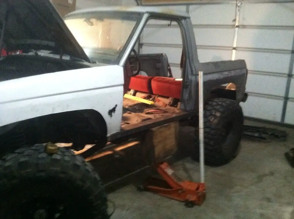

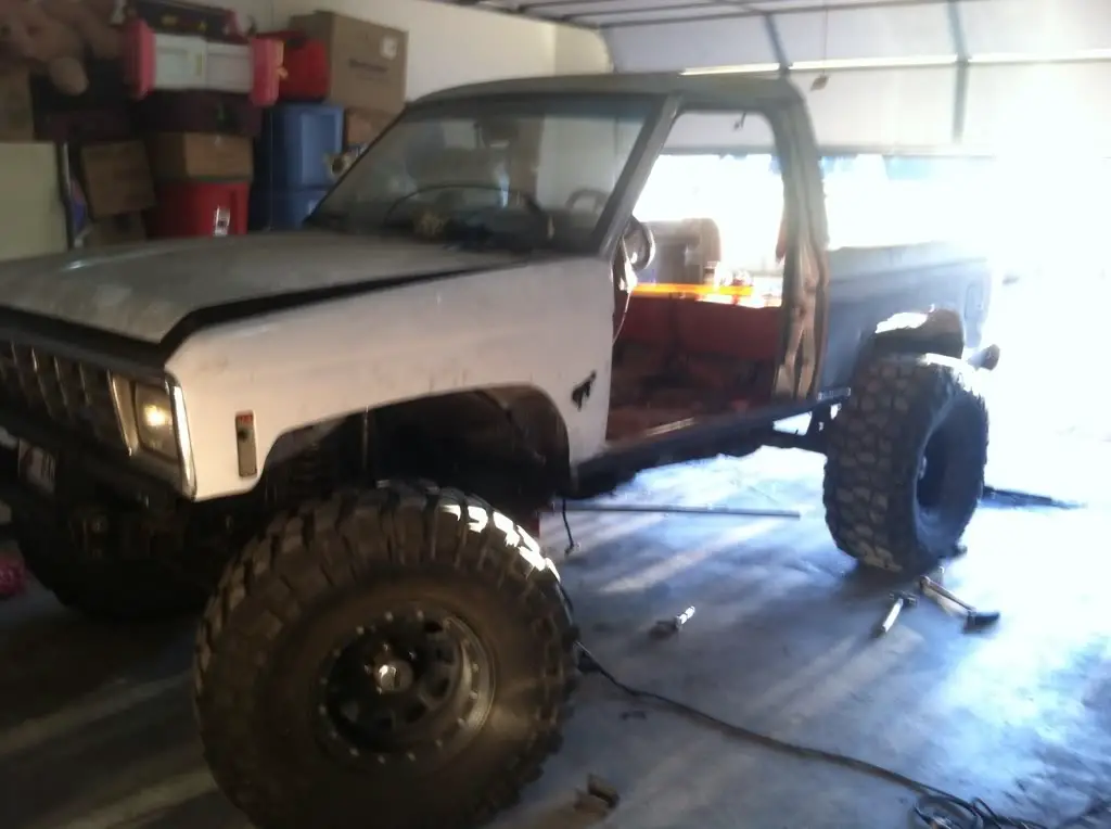

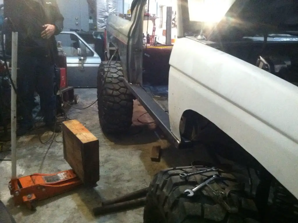

to put the guard on my grinder, I was busy doing this,

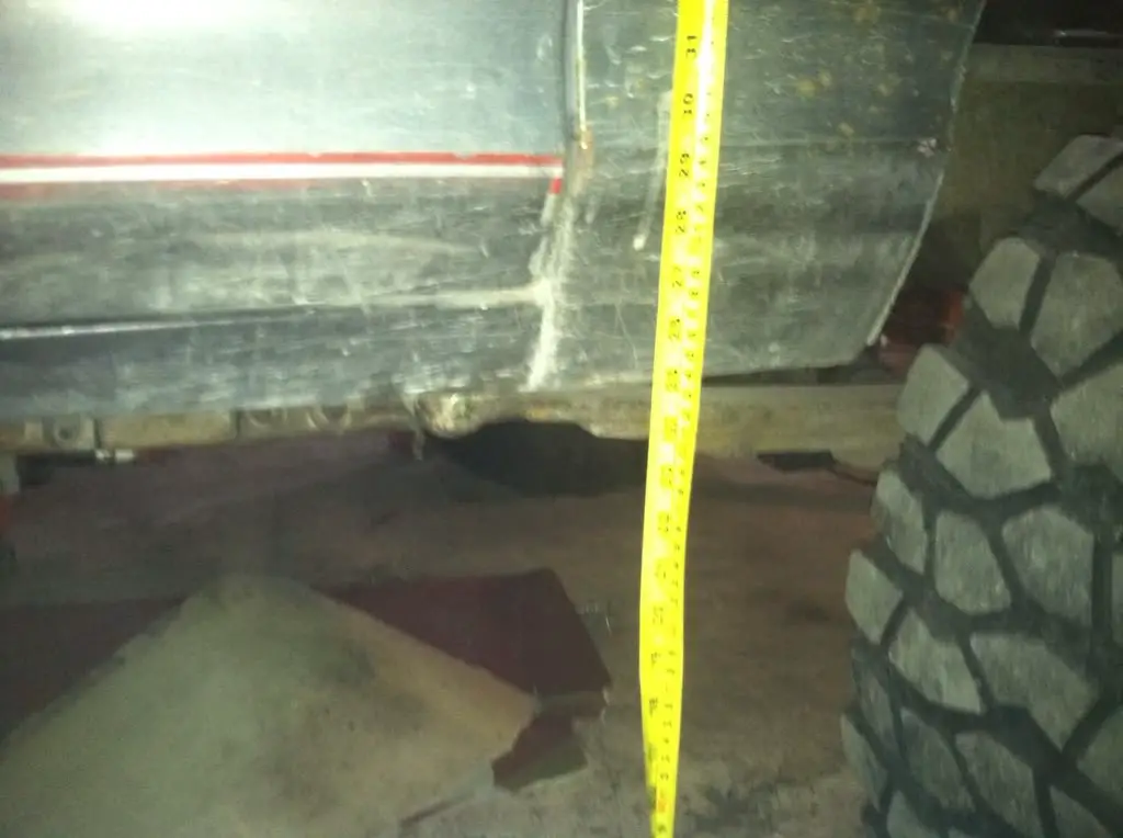

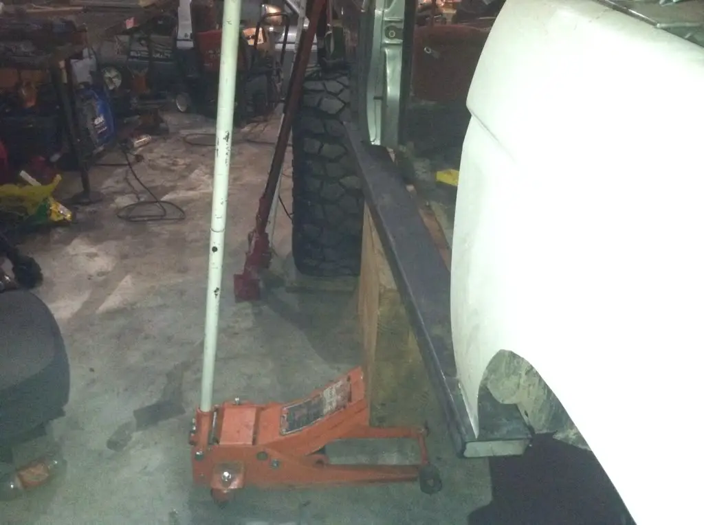

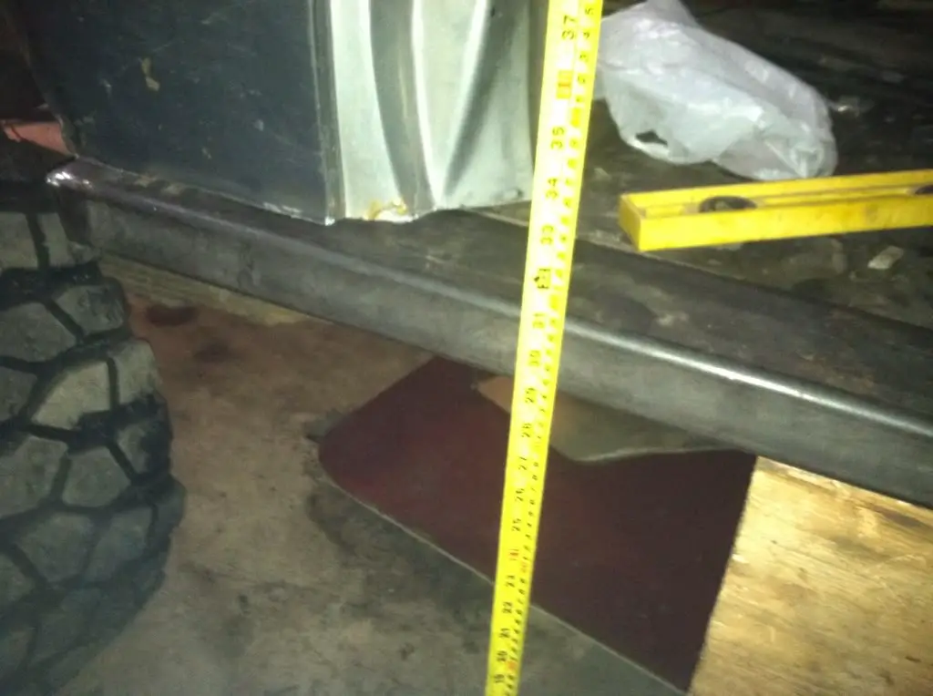

thats 4" higher than the rocker panel on the other side, and when you take into consideration that most peeps put their sliders below the rockers ive got 6" or so on a similar lifted bII. pretty pleased with how they are coming along.
Looks great, I'm talking about all five fingers on your left hand...hope the right still has 5 lol.
Now is that slider up on top of the frames that come off perpendicular to the main frame?
Really does look good. I like the way it cleans it up and your not even close to finishing it up as far as tying in suppose.

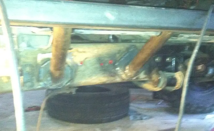

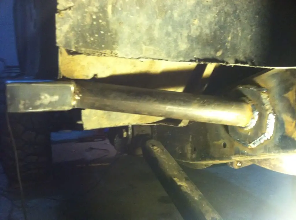

there are 4 supports that come directly off the frame, 2 in the middle and one on either end of the tube, here are the middle ones,
and here is the front one,
im tired now so the back one will have to wait till tomorrow

Thats the most innovative slider for a B2 ever!! Clearance, strength & looks great too...couldn't ask for much more.

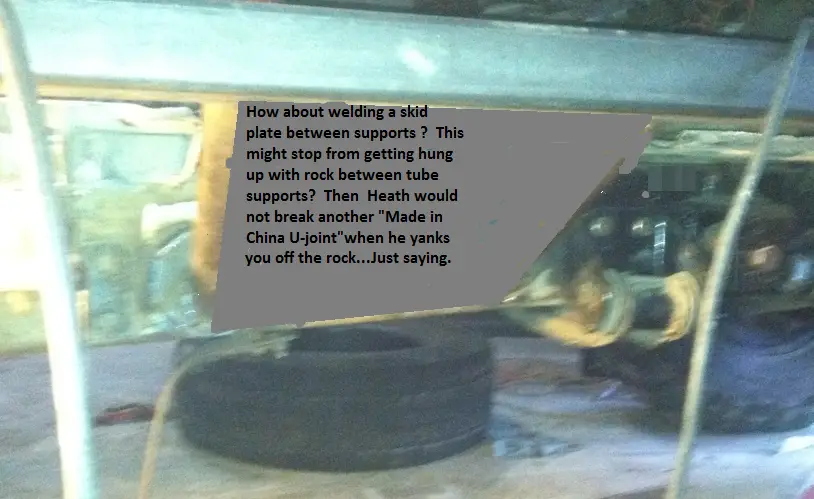

the original plan was to actually boatside it and put a plate right there, but at this point its probably not going to happen, the 2 middle supports are actually not at the same angle, so it would suck to attach them.
Rick C good to see you on here, seriously don't be a stranger. thanks for the compliment on the sliders, they are a really nice peice that is going to function well. they are giving me a lot of ground clearance over someone who has the same amnt of lift but put their sliders under the rocker, im 4" above the original rocker location. isn't it funny how one part can be your favorite and no one else will ever notice, that front support worked out so well I can't believe it, and the welds look nice too lol.
I got the back support in this morning, man that was the most complicated piece of straight tube ive ever dealt with, I screwed it up 2x, I hope I can use the wasted tube on the other side lol. here is the back one,

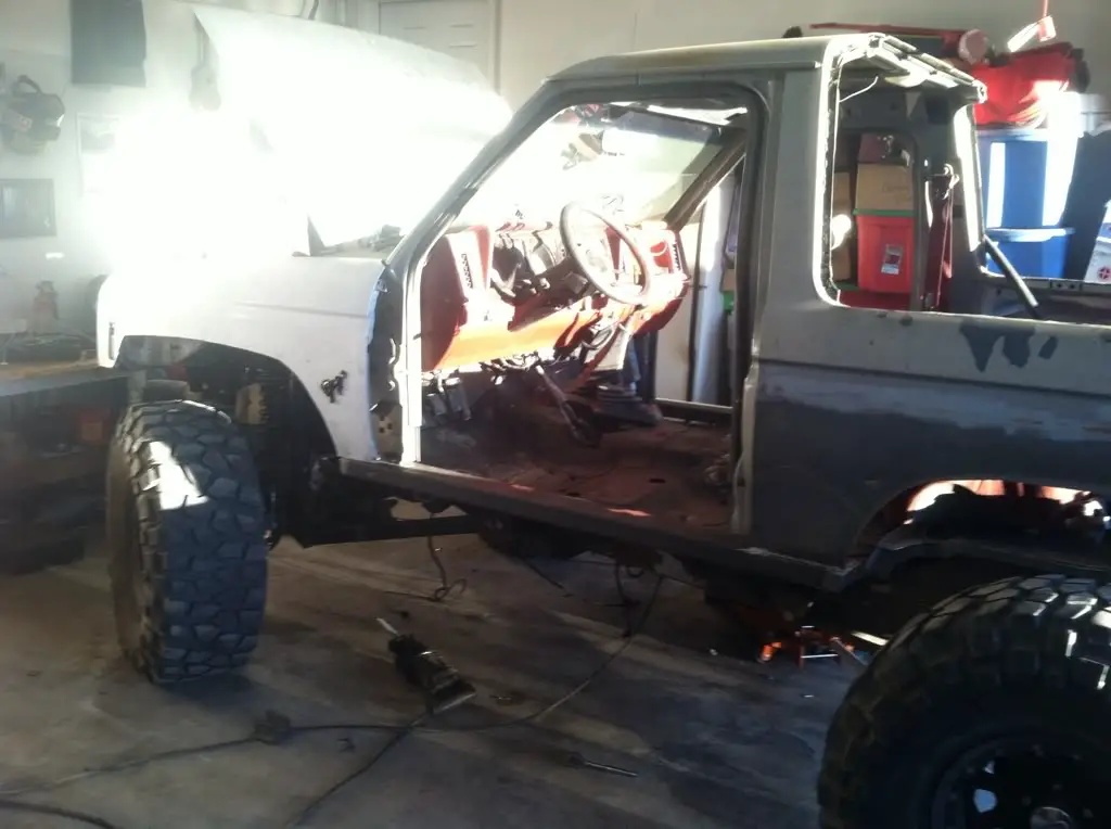

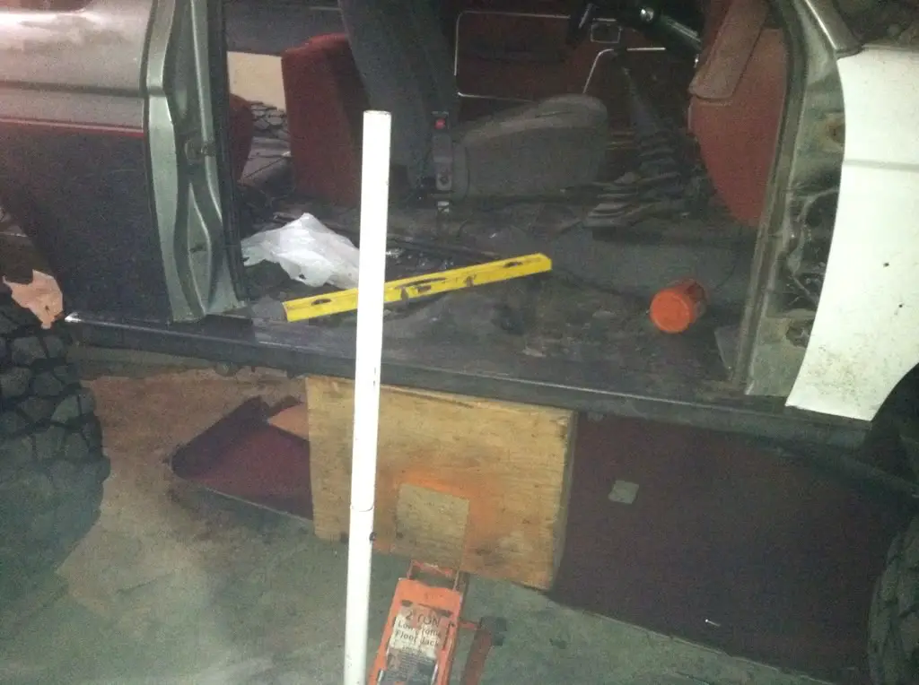

had dinner at my parents house with all my brothers yesterday bk they will all be gone next week for easter, so when I got home I was tired and not really feeling working on the bdos. but it was ready to cut and there was a fresh blade in the sawzall, so I went for it. came out perfect, exactly the same height as the other side, which is saying something with my sawzall skills haha. this is the side that is not going to be that fun bk it has all the brake and fuel lines inside the framerail that need to be moved before welding can begin. guess thats the nature of the beast though.
Looks good man.
