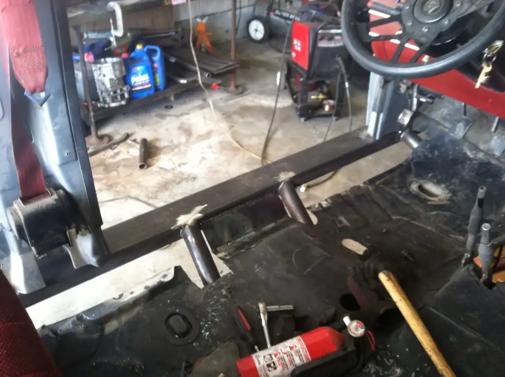

Might make for a good place to attach the rear roll bar piece. Just cut through bed and weld directly on top of rect. tube.

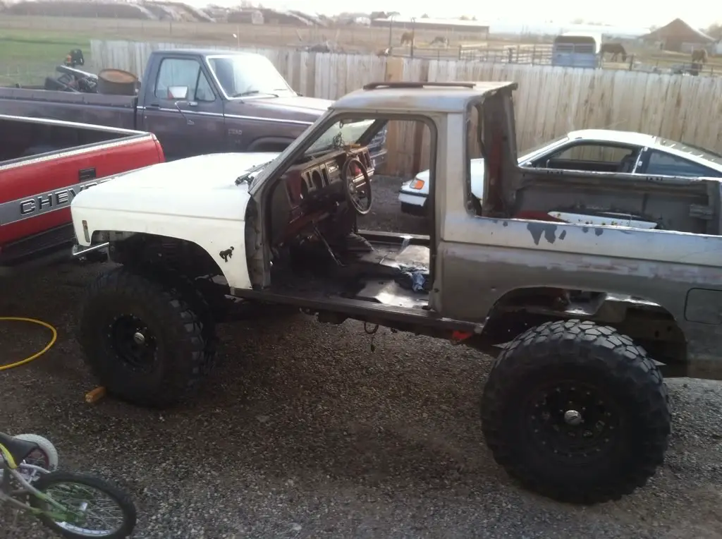

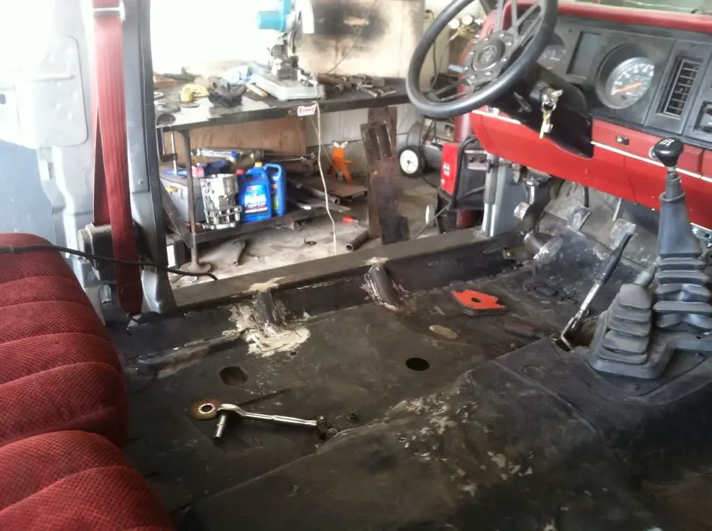

thats the plan, the front pillar will follow the roof and windsheild line, then dive inside the fender and down to the slider, as shown here
and on the back the b pillar will be fully inside the vehicle, its going to be kind of an interior/exo cage, the main purpose of it being to keep interior room in the front. thats actually why I put the front and rear supports on there, not bk the slider needed them, I could wheel on the 2 middle ones forever, but so that the cage had a support that was tied into the frame and so I didn't end up with a dead node on the attachement to the sliders. should be pretty beefy. here is the attachement point in the back,
Excellent engineering and well thought out.
I want to occasionally ride with Jon and I am a couple inches taller than him. No way we could fit a cage that would fit me it would barely fit Jon if we did full interior.
Besides the cool factor of having tubes appear out of the fender and then come back inside at the back.
Should turn out way cool

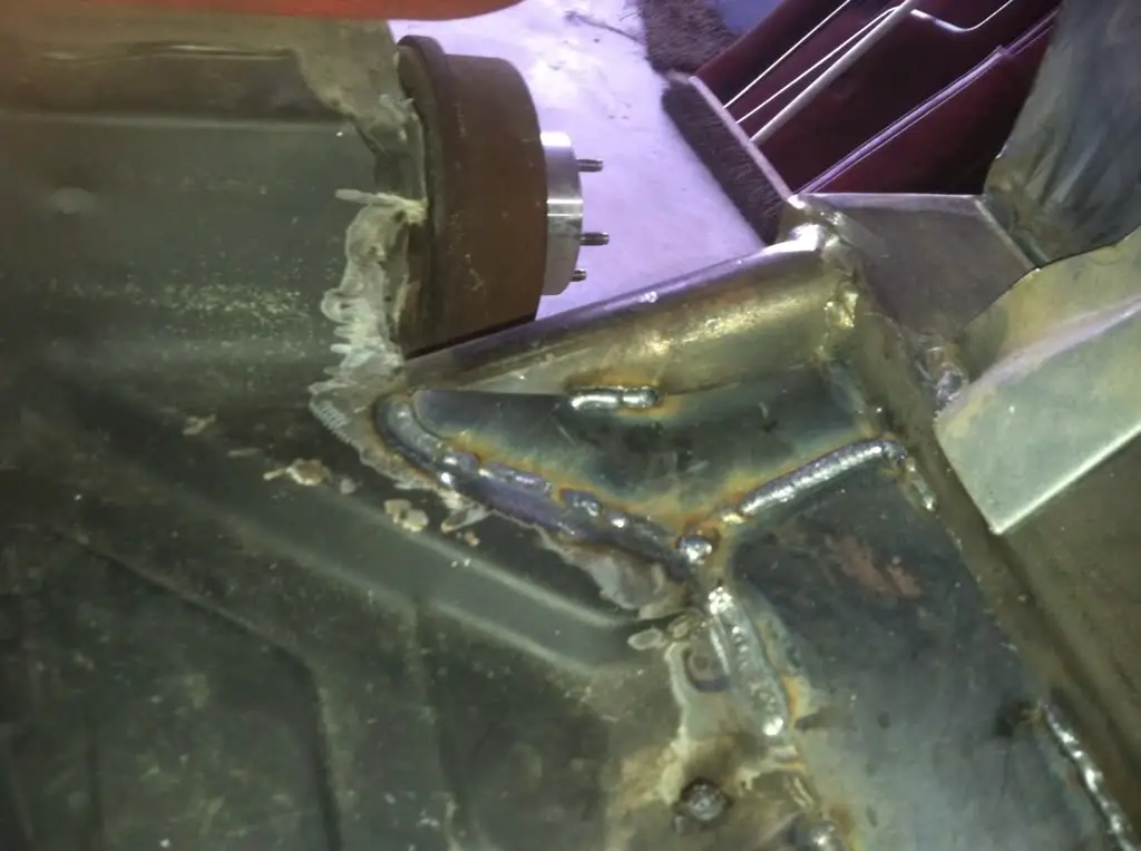

props definitely go to Eric for the interior exterior cage idea, I think he is just trying to pimp his creativity on my rig though haha. the interior room is going to be nice, not to mention knowing that the rig is protected on the outside, plus its just gonna look *****in. getting pretty excited about it. I finished the rear support today, just need to do the front one and then start patching sheet metal.

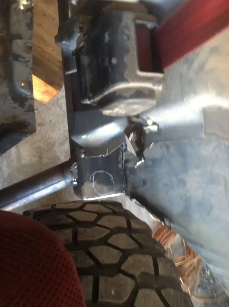

don't laugh at my poor sheetmetal skils, it does help that its a little bit thicker stuff than I normally would have worked with. But it will seal the cab up and I think it looks *****in with the tube coming through the floor and connecting to the slider.
I really like it. It looks so cool the way it blends together. Throw in some bed liner on it and it looks like it rolled out of the show room floor.
And to do this without the use of a fully equipped sheet metal shop is great.
Plus could put some RTV sealer on it also other then trying to make air tight welds. and then some bedliner over it, if you like.

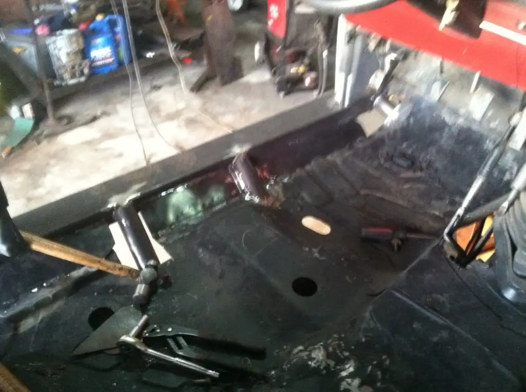

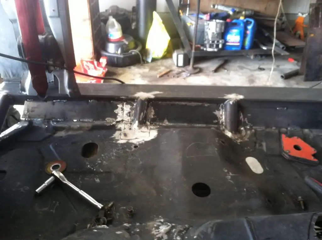

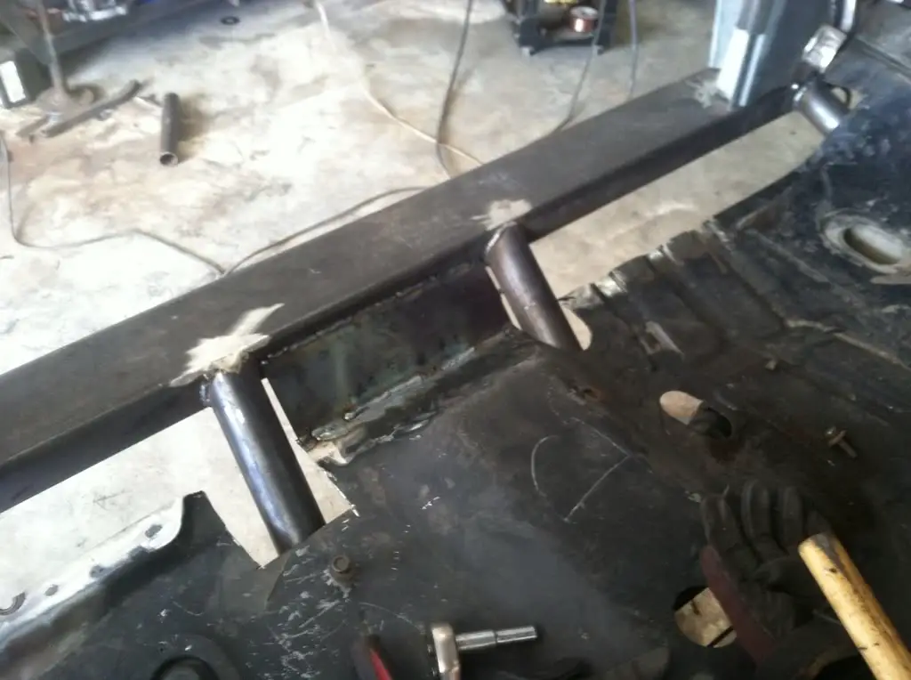

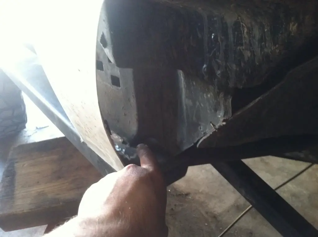

Ive had the inlaws visiting for the past few days so no chance to work on the bII. finally got the opportunity for a few hrs today, I was able to patch in the other middle bar today as well as both ends, still have a lot of grinding to do, I think its going to get to a point where I just give up on the grinding and paint over it, but I'm going to get the die grinder out and try to get some of the spots the angle grinder doesn't fit inside. here are a few pics.
It's just because the flash highlighted the shiny spots of the grinding marks. Taking pics of welded metal with low light that needs a flash and has been ground on is tough to do. If there is enough natural light sometimes that is the best way to do and forget the flash. Many times with a real camera ha ha I'll just take a few different shots until it looks like the real deal.

raise your hand if you think i need bigger tires
haha jk well not really , I think my tires look a little bit small. guess I cut the wheel openings to big.
heath go take the tread lightly test, also don't tell my wife that my tires are big enough, as far as she is concerned i have the tiniest tires ever.

That thing just beckons cage/exo. What are you going to do for seats?
