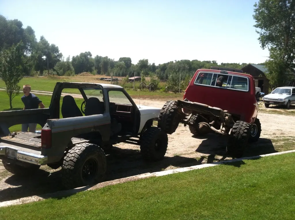

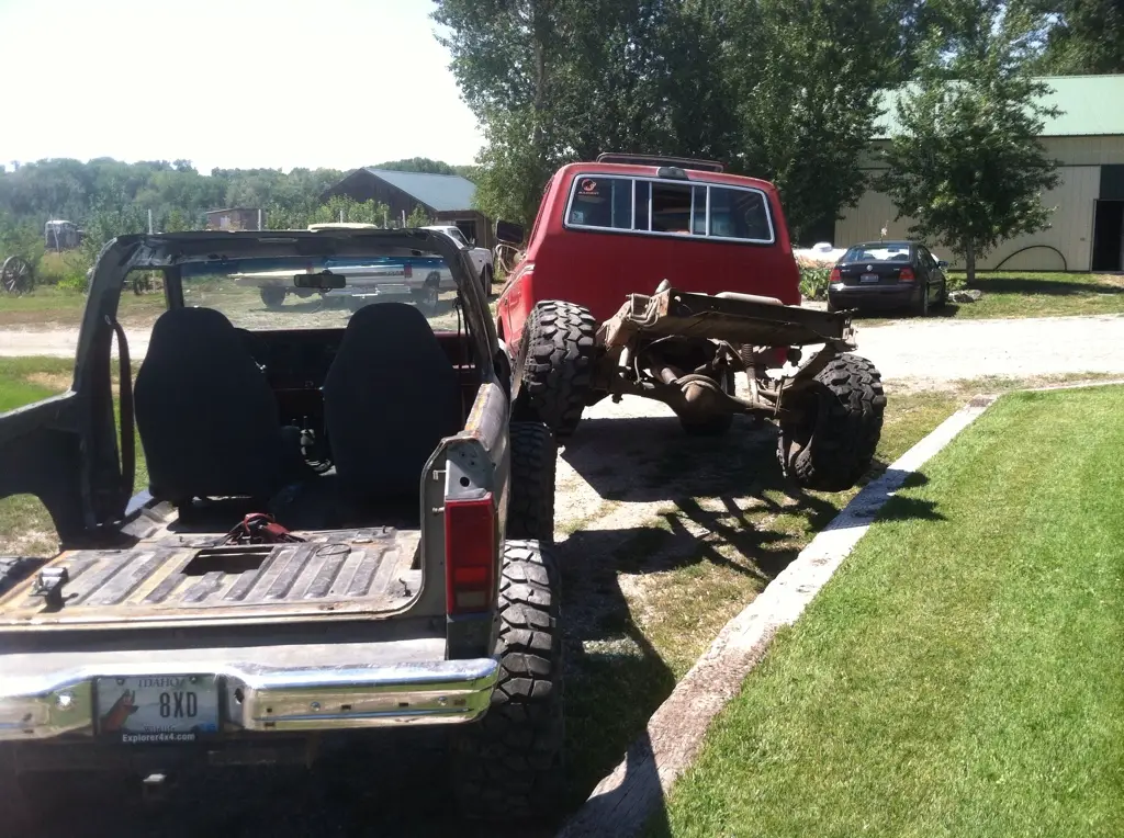

here are some driveway fun pics from friday, went to set up for my brothers wedding and ended up screwing around with the trucks haha,
he has zero flex in that thing, the springs are super stiff, he is shock limited, and his shackles are completely frozen solid. still popped his tire up on mine haha, it may look like his passenger rear is on those railroad ties but it isn't, it is a foot and a half off the ground haha.
Wow I thought it was on the railroad ties too!
Dang Josh really doesn't have any flex does he.
no it really is pathetic, we put a breaker bar on the bolts with a 3ft cheater and couldn't break the bolts on the shackles loose, we need to get some 63" rear springs in that thing. I was hoping maybe we could make something work with the ones in it but its not going to happen

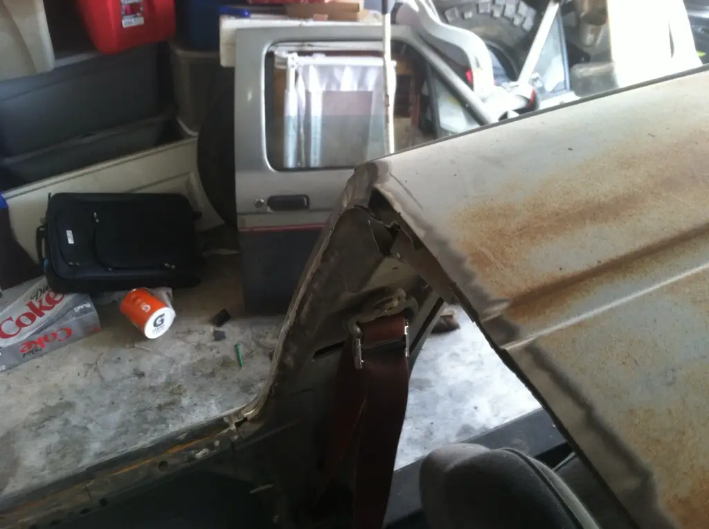

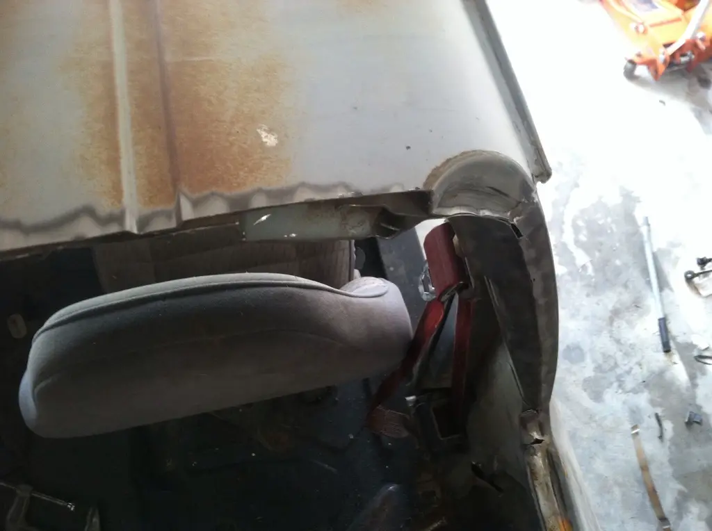

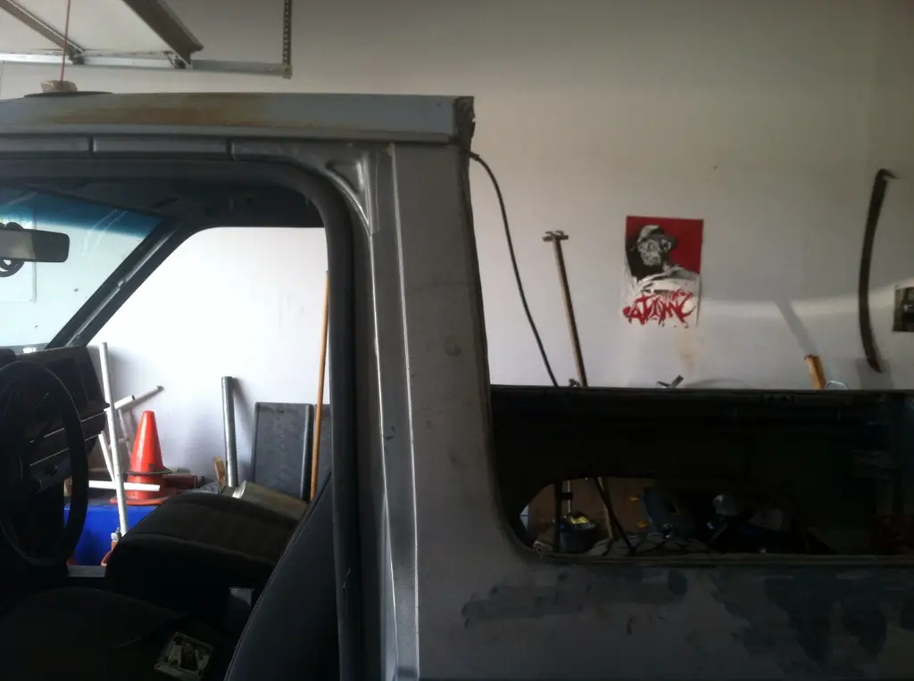

ok so I got off my ass today and did a little bit of work on the bdos, I need the back of the cab where I cut the roof off cleaned up so I can put some tube work there. I cut it off even and welded the actual roof to the support underneath, just need to cap where the roof uses to attach on the corners and i will call it good, there is going to be a peice of 1 3/4" dom in front of it anyway, I just want it to be clean.

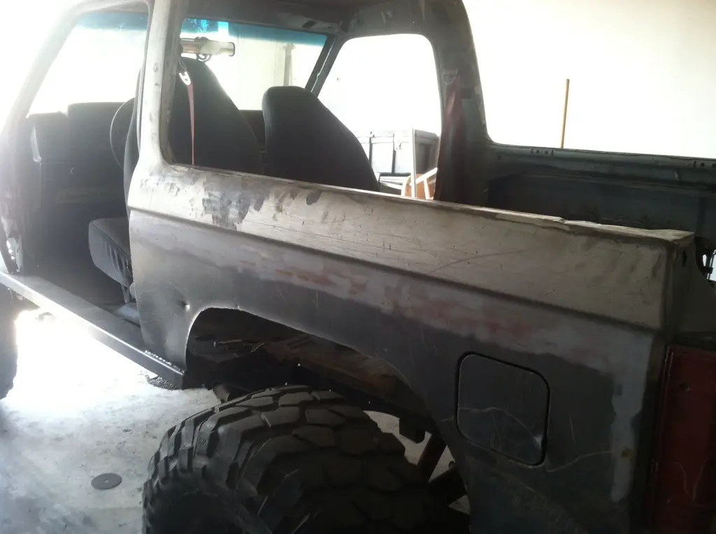

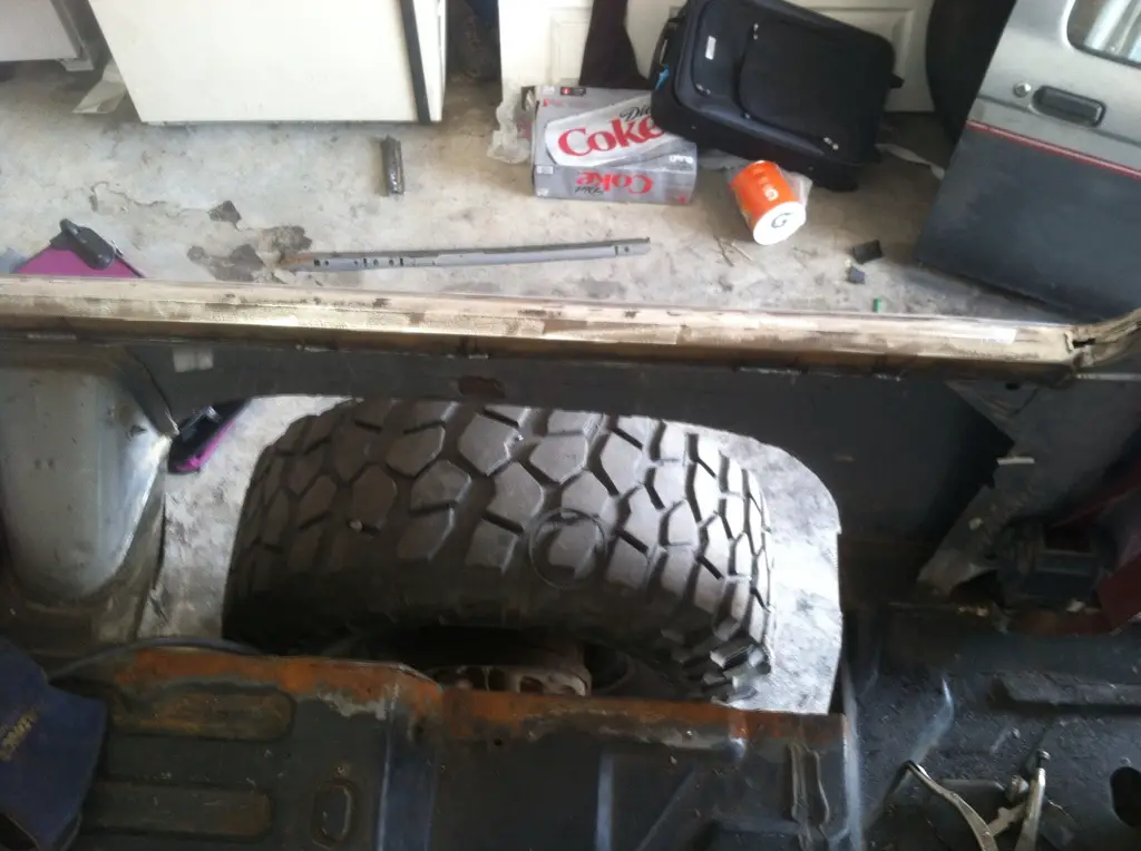

also going to look at cutting out the bed rails and welding in some 1.5x1.5" angle iron I have laying around, just to clean it up a little, no sense in my rig looking like a pos rolling down the trail.

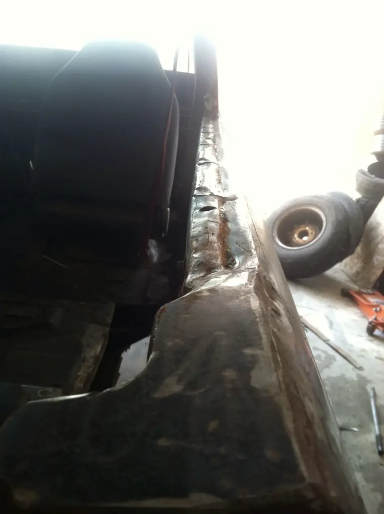

I realize now that those pics suck haha, sorry. I started on the bedsides today, I think they are coming out pretty dang nice, here are some pics of the passenger side and the new and improved driver side,
Lookin better and better.

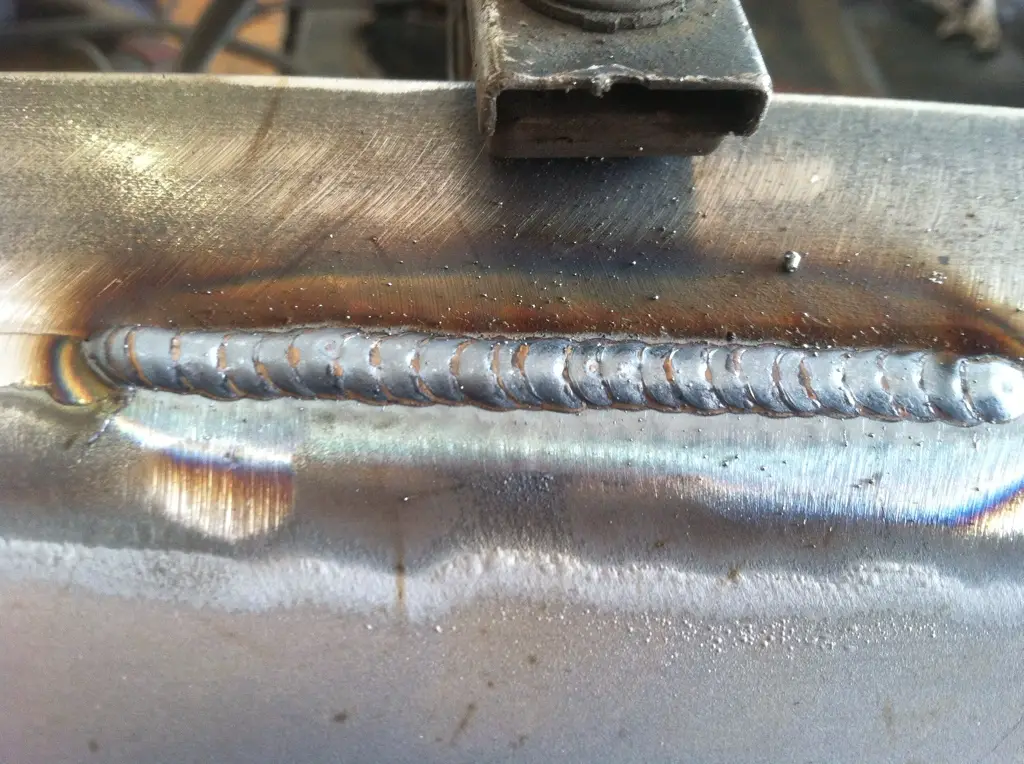

lets put the rumors and accusations to bed, I can hold my own with the welder,
shoulda thought about me welding a gusset into your hood latch before you started bagging on my skills son!

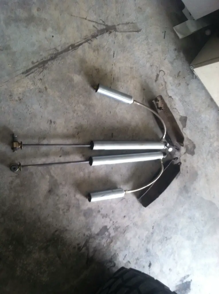

I was driving down one of the dirt roads in the woods by my parents house and the bdos got a little squirelly on me, I'm pretty sure it was bk my shocks are shot, so I decided it was time for these to go on,

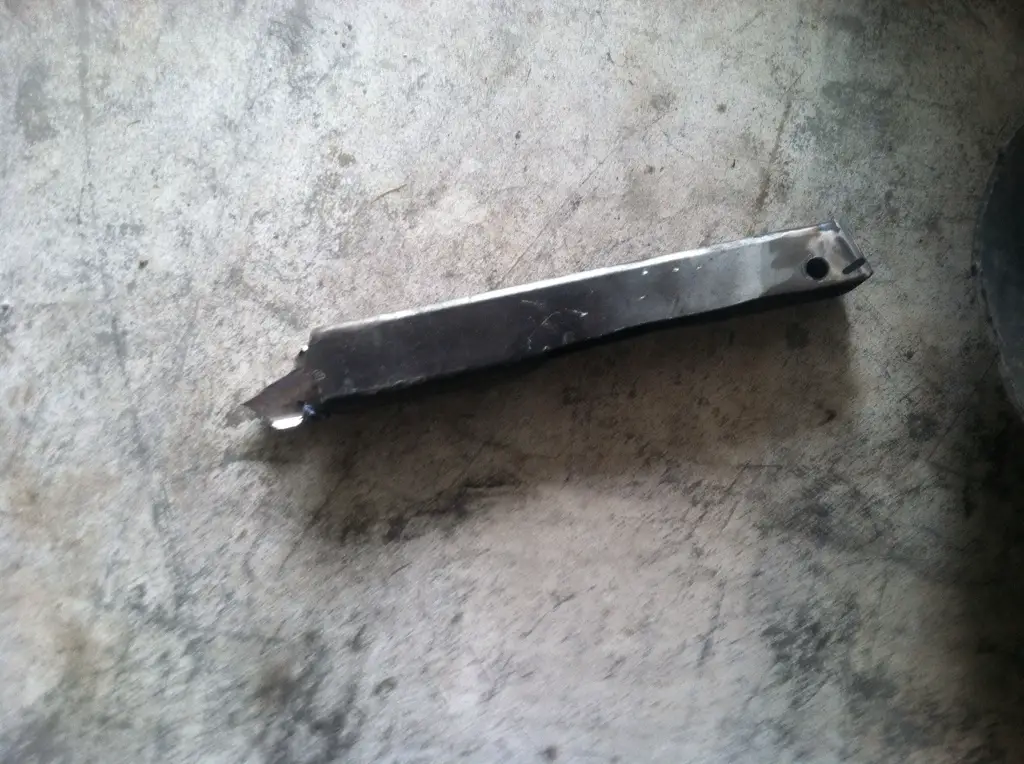

had to cut off the old mounts, the shocks had to be mounted up which meant I needed some f250 towers, happily Eric had some kicking around the shop, so here is the old mount, minus a few inches,
and here is the shocks and tower tacked in place,
the other shoocl mount he had modified to be straight up and down instead of being kicked out at a 70 deg angle, so now I need to modify it, ill post up pics of that when I get back out in the garage.
kinda forgot to take pics until I had it in and was painting it haha, I had to cut the side and beat on it with a hammer until I acheived 70 degrees to match the other side,
i'm gonna go for a drive tonight and see if I improved my rig in doing this.
these shocks are sweet, but my on road ride is def improved with these shocks, the old ones were obviously shot. I think at this point the only thing I can do is improve my suspension geometry, my suspension has some flaws in it. namely not enough vertical seperation at the frame end, this was caused by how high I put the frame end mounts on the lower links and the fact that I had no room to go any higher with the frame mount for the upper. I briefly visited the idea of a rad arm on the driver side and leave the existing link on the passenger side. but i'm worried at the angle my lowers are at my suspension would unload really bad, ill probably leave it as is. it performs very well in the rocks, and it is driveable on the street if I have to drive it there. btw 1000th post on EF!!! seems like only yesterday I was asking stupid questions all the time haha
Just wondering about your shock towers being that high. Wonder if you took a gusset from the upper end of the shock tower to the top of the coil bucket to keep the shock tower from flexing?
Congrats on your 1K post.
I thought about doing that but my coil buckets are adjustable and i think i want to go one bolt hole down, to raise the suspension back to level. They dont flew noticably but i agree there could be a problem there if it isnt adressed
