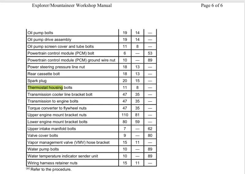

have a 2001 4.0 SOHC , what are the lower thermostat housing bolts to intake torque spec? I have the Haynes manual I didn’t see it in there. Any info, thanks in advance
