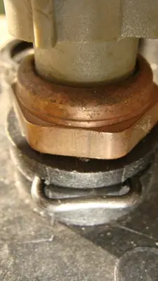

Your '98 has the older threaded sensors and housing unless it was repaired.
I believe the older sensors are also different sizes. (See pic in the link below)
Physically look at the base of the sensors and look for these retainer clips.
http://www.explorerforum.com/forums/showthread.php?t=310429
