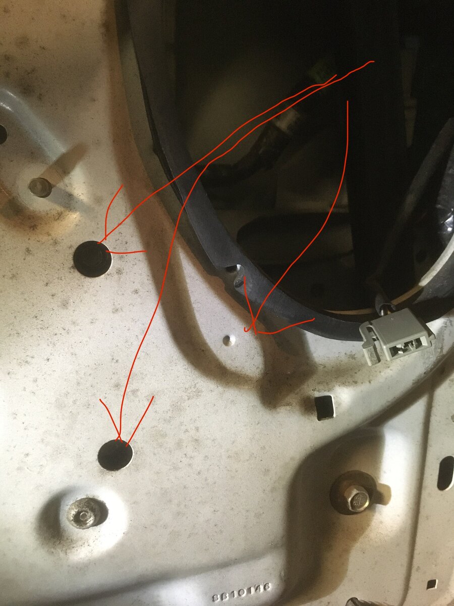

Pull the door panel off. The motor is bolted to the regulator assembly inside the door with 3 bolts. You will need to drill a hole in the steel inner door frame to access one of these. It is already dimpled from the factory in the correct location. See the first picture. Strangely the other 2 are drilled from the factory.

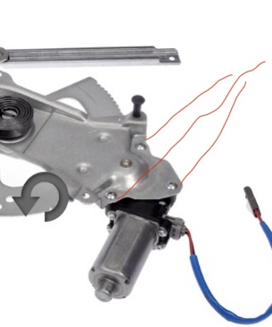

The last picture is what the motor looks like and the 3 screws that holds it to the regulator linkage that you will be removing through the outside panel.
