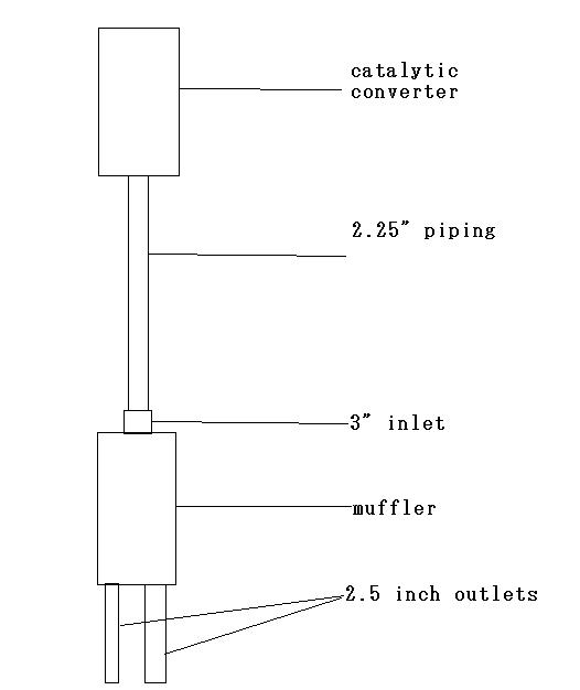

Rob, is this setup right? I got it from your Youtube information, Just making sure I have it right. I'd like to keep everything single, meaning I don't' want to run duals yet. But if I need to I will. I kinda like 45' exhaust tips :-)

that's sounds a lot like mine. Sept mines lower.
