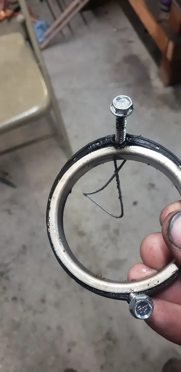

It's a rebuilt crate engine, not sure if they used oem parts. It's from exact power. The whole underside is covered in oil. It's all over the exhaust and it smoking. So I'm just gonna drop the tranny to replace it.

Someone didn't use a speedy sleeve :dunno:

Looks like it was installed backwards the sleeve stays on the crankshaft to provide a new surface for the new seal
But I'm probably wrong lol
Idk I've never seen them like that usually it's just a seal. Luber it up install and its good
hope that fixes the problem! and no other problems arise! looking forward to the results!
All looks good! Drives well, no leaks!
