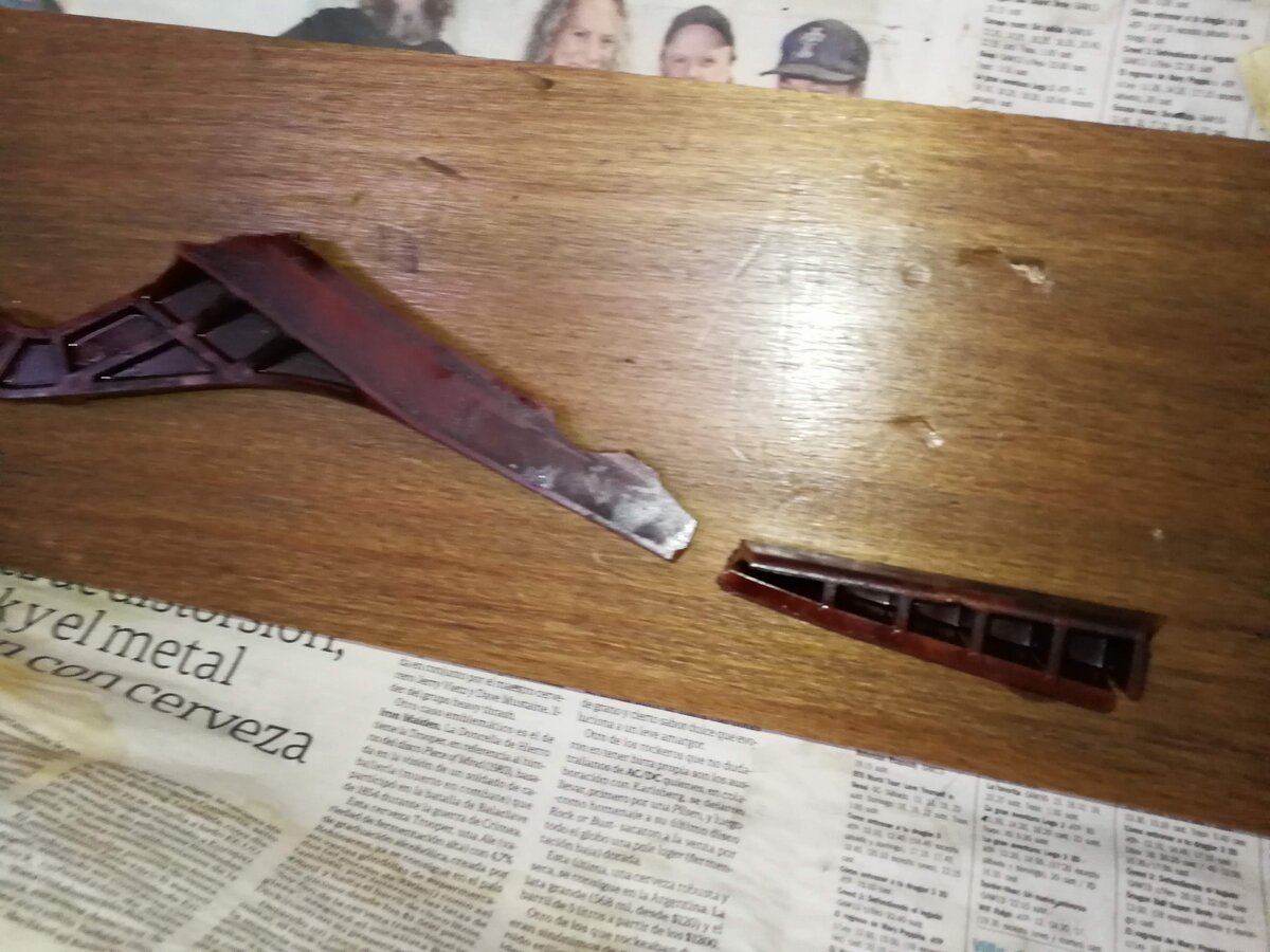

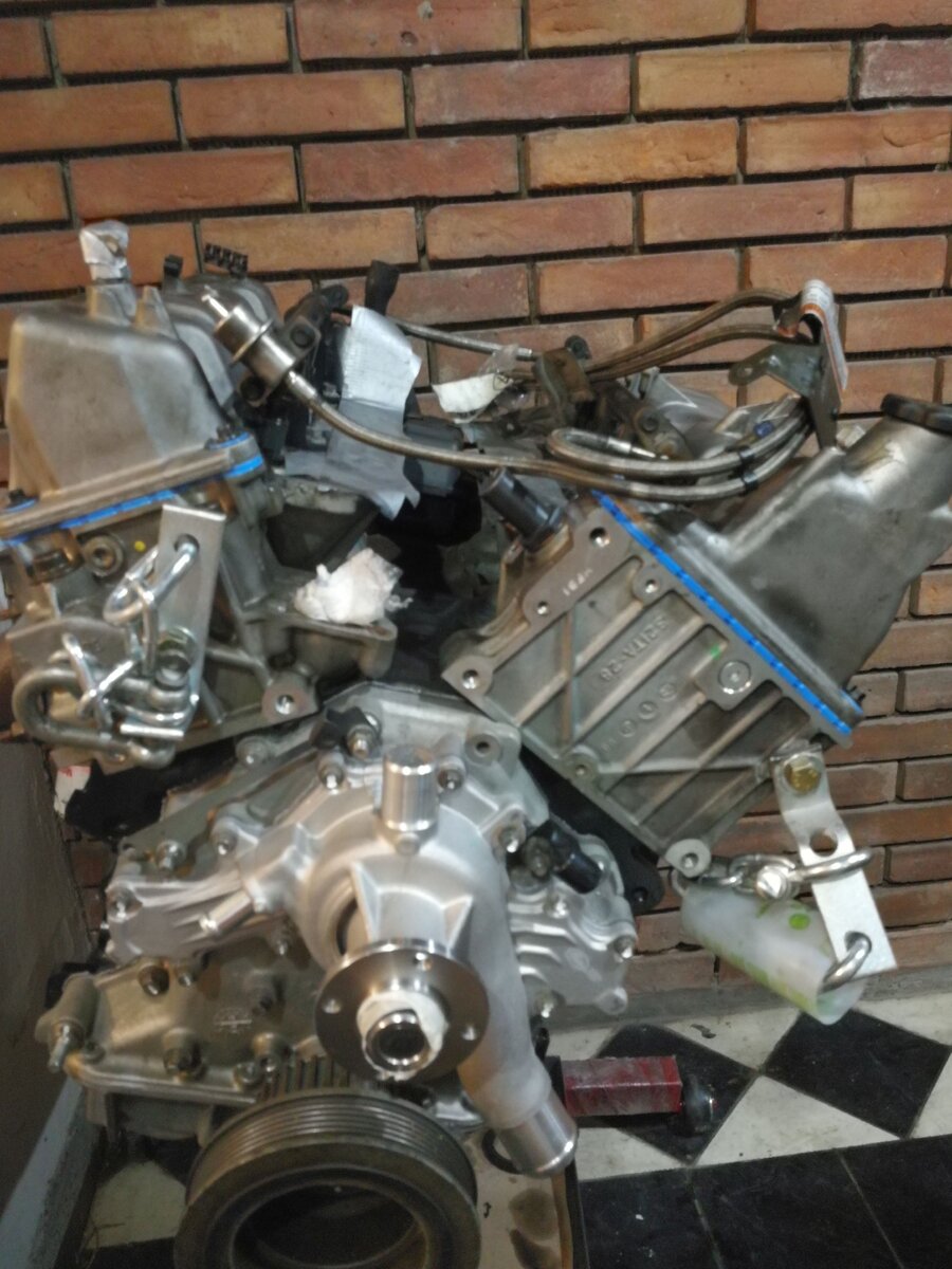

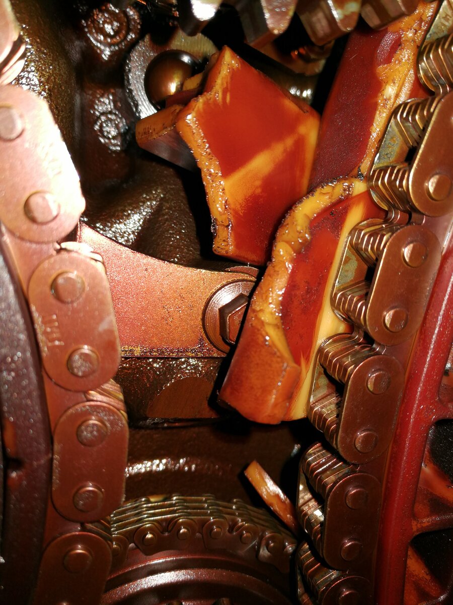

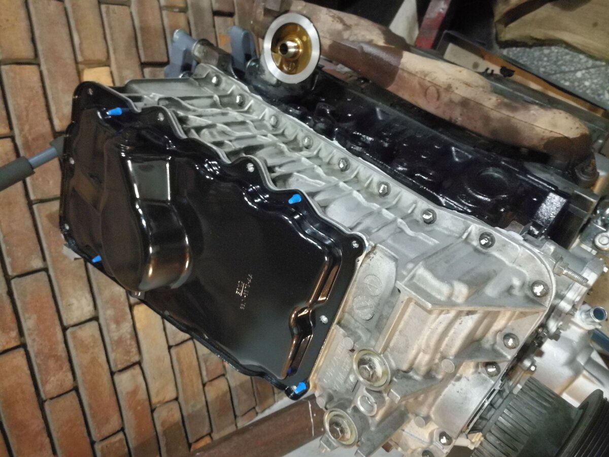

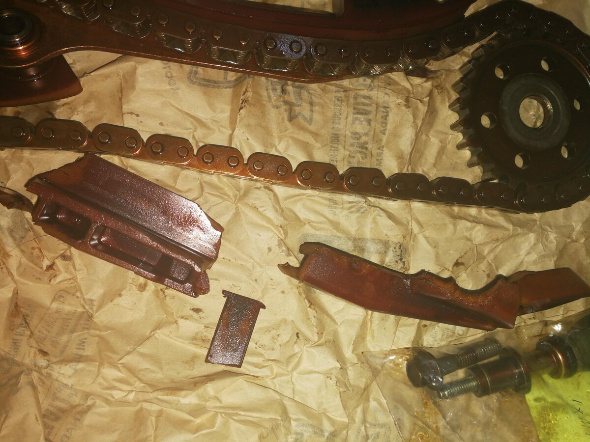

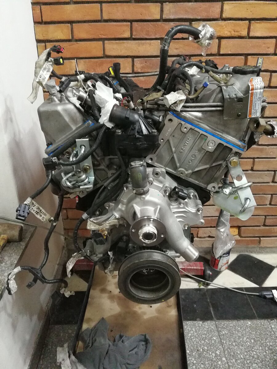

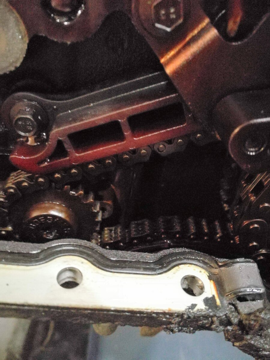

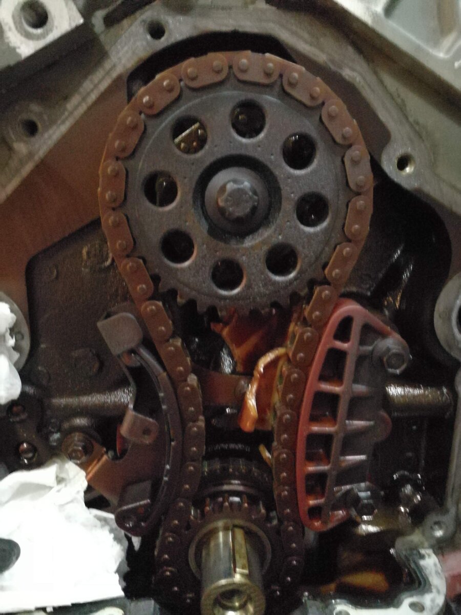

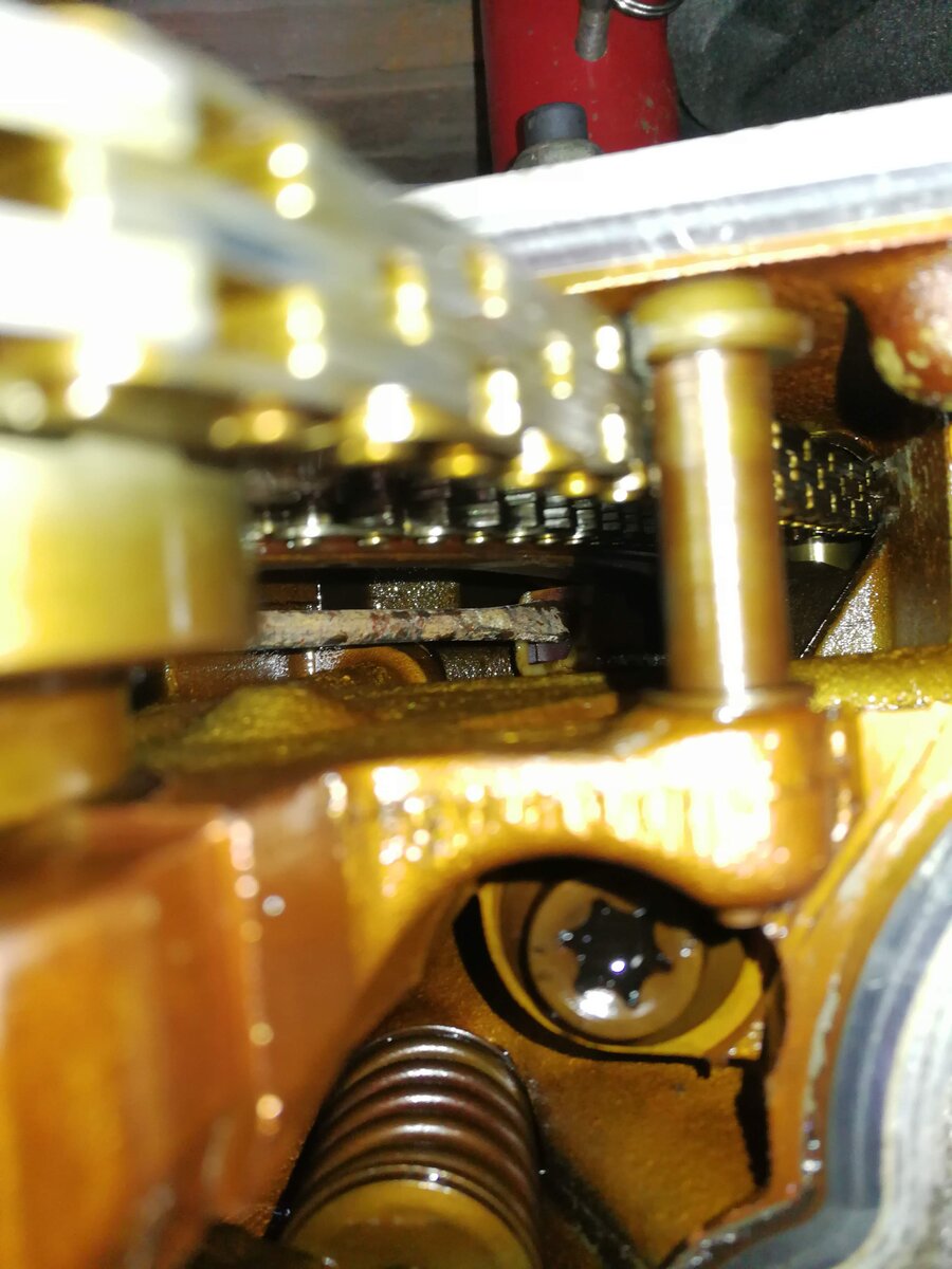

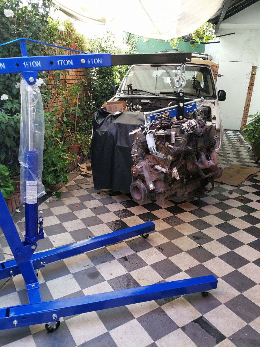

Hi you there,
Here my contribution to this forum. It´s a couple of Excel files and a PDF indicating:
- A needed / recommended Part Number list to buy before doing the job
- A step by step checklist that helped me a lot to not forget a single bolt/nut/gasket or "Should done that before".
https://docs.google.com/spreadsheets/d/1l9yk51Cx0UqE7xHhnGjsQbrQ4WQYV3Jj/edit?usp=sharing&ouid=112986964640316495952&rtpof=true&sd=true,
- A PDF with photos made by a couple of swede guys who get the job done
I´ve did the timing chain replacement during pandemics but never got time to post it after that up today.

IMG_20200307_152751.jpg IMG_20200313_085635.jpg IMG_20200313_090123.jpg IMG_20200314_105059.jpg IMG_20200314_105107.jpg IMG_20200314_105112.jpg IMG_20200314_105117.jpg IMG_20200318_191254.jpg IMG_20200321_194520.jpg IMG_20200321_213120.jpg IMG_20200331_115715.jpg IMG_20200510_173616.jpg
