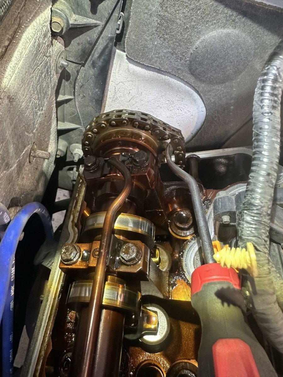

So at some point my original hydraulic tensioners lost some of it's tension thus resulting in that slack which lead to my broken guides. :(
Such a brilliant design.
And you are right about the removal of the tensioners being a bit more involved on the years you mentioned. That's what I face on my 99 sohc engine.
I'll be pulling out the engine and replacing all timing chain components. I felt it would be convenient to install the manual tensioner upon reassembly of the engine although it was suggested that it would be best to install the hydraulic tensioner first and then after a few hundred miles do the swap.
Installing the mechanical tensioner seems simple enough. As long as I don't put any excessive tension on the chains, how can I mess this up doing it from the get go?
