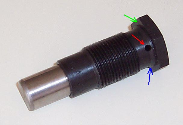

Well I got this all wrapped up, now I am having a "Ticking" Problem. It's evident all through the RPM's. and is coming from the right rear of the engine. I have not been successful getting the right chain tensioner installed properly, for the life of me those oil holes won't line up...it's leaking a little. Could this be the problem? Any light would be great!
oil hole alignment
The oil hole in the tensioner does not have to align with the oil hole in the head. The smaller diameter of the tensioner between the threads and the sealing surface allows oil from the head to circulate around the circumference of the tensioner. Did you install a compression ring? If so, did you use some grease to hold it in place when screwing the tensioner in? If not, the ring may have slipped out of position.
