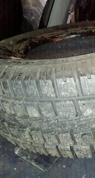

So I bought some lightly used 31x10.5r15 tires.
They are Cooper Discover M+S.
Apparently they are dedicated winter tires but I wanted some LT 31s for summer because shale rock terrifies me.
The thing is, these tires despite being in good condition ( still smell fresh, have lots of tread)
They are 12 years old and the rubber isn't very soft anymore and there is some very VERY light cracking between the tread blocks.
Think running them as summers would be justified? Especially since they were only $200
I think you'll be fine. Tire technology is so good these days even the cheap tires are better than expensive ones 25 years ago. I have some tires a little older than yours still in service. I'm slowly replacing them now as they are close to 20 years old, but I'm not afraid to run them anywhere. Just make sure you keep them inflated and check them occasionally.

I would not use 12 year old tires; just too risky, even if they look ok.
For $200, you should have alot better choices of younger tires. Just look on Craigslist
12 year old tires I'd be on the fence but as long as they looked great I'd use them. I've put some miles on 13 year old sunbaked tires and 35 year old garaged tires and you could tell when it was time to get rid of them- all of the signs were obvious. I've got a brand new set of BFG A/T KO 1's from 2014 that have zero miles on them and they've been garaged the entire time and I plan on using the hell out of them when the Explorer is up and running again. Just check your tires every once in a while and if they display serious integrity issues then dump them.
The most common cause of failure in a tire is being run with low pressure. Look at the inner liner, if there is any deformation or scrubbing in the sidewall then discard it. If there is powdery rubber inside the tire, discard it. If there is major cracking in the shoulder of the tread, discard it. Many tires with a combination of these signs will indicate a tire run low or flat. At that point the sidewall belts are compromised and have have begun to separate.
Keep in mind, recap tires for trucks can be on 25 year old carcasses. As long as it's still serviceable, they will use them over several times. Just not on steer axles.
Other than that, I have no problem running any tire, any age. Make sure you keep an eye on the pressure. That's the most important thing you can do. Low pressure equals high heat due to friction.
I'd like to clarify that I am a tire technician.
I'm not so much asking about if the tires are in safe enough condition to use.
More along the lines confirming my logic that they should be decent enough for summer back bush driving.
