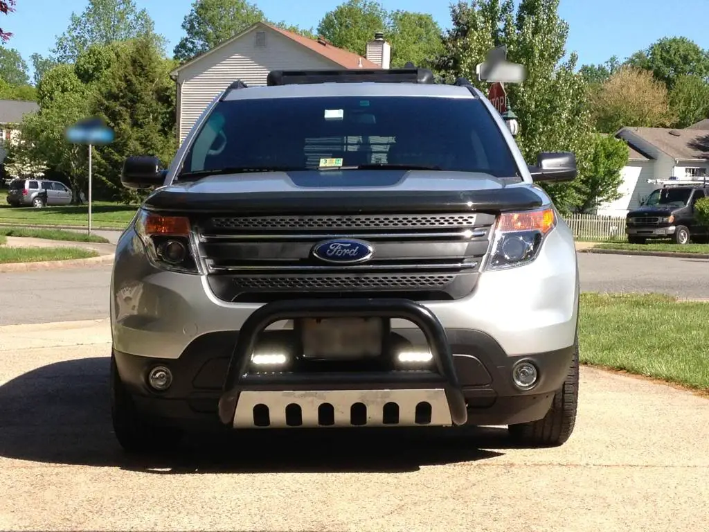

Two weeks ago I installed Philips LED daytime running lamps which are plug and play. I did not tap into existing lighting or wires. I know I have to bring it to the dealer but any thoughts on whether additional lighting may have voided my warranty or been the cause of my issues?

I installed the Philips DRL 4 led light set. Super easy to install.
