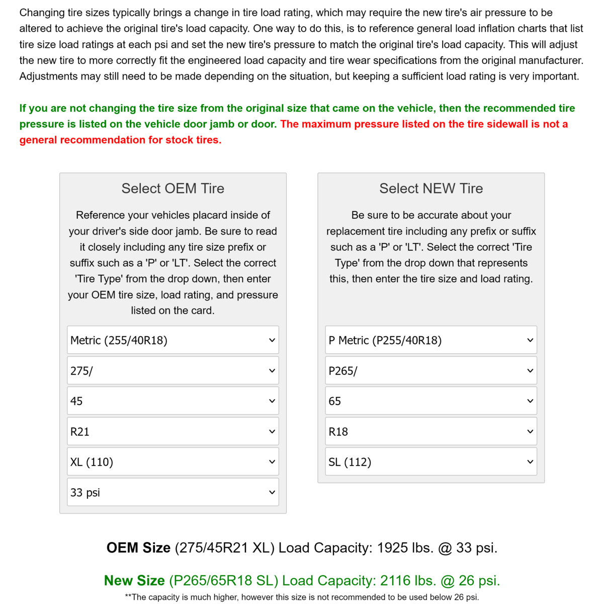

Used Tire Pressure Calculator on Tire Pressure Calculator to determine the recommended air pressure for my new Blizzak P265/65 R18 tires.
Because the 18s are significantly different than the oem 21s I'm looking for the best pressure to run the new Blizzaks.
The Tire Pressure Calculator appears to be basing it's recommendations using a Load Capacity priority and it's recommendation of 26 psi seems too low for actual use conditions. Currently I'm running 31 psi (cold). Any thoughts or recommendations?
