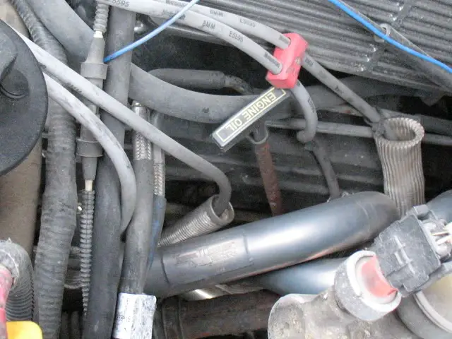

no they will not since there is one tube on the driver side header that crosses over the steering shaft.
semi decent pic of the driver side
so you best off to pull the engine first do what ya need to do reinstall it and intall the header.

sorry dave, i am going to prove you wrong on this one. the headers can be left on when you put the motor in. what you have to do is, unbolt the steering shaft, and swing it forward, and you can slide the motor in. out, i, cant say for sure. if you go this route, unbolt the motor from the motor mount plates, bolt the plates, and the mounts as a unit into the frame, then put the motor in. its not to bad. i just did this with my 98 sport v6 to v8 swap, and was very surprised how easy it went in.
