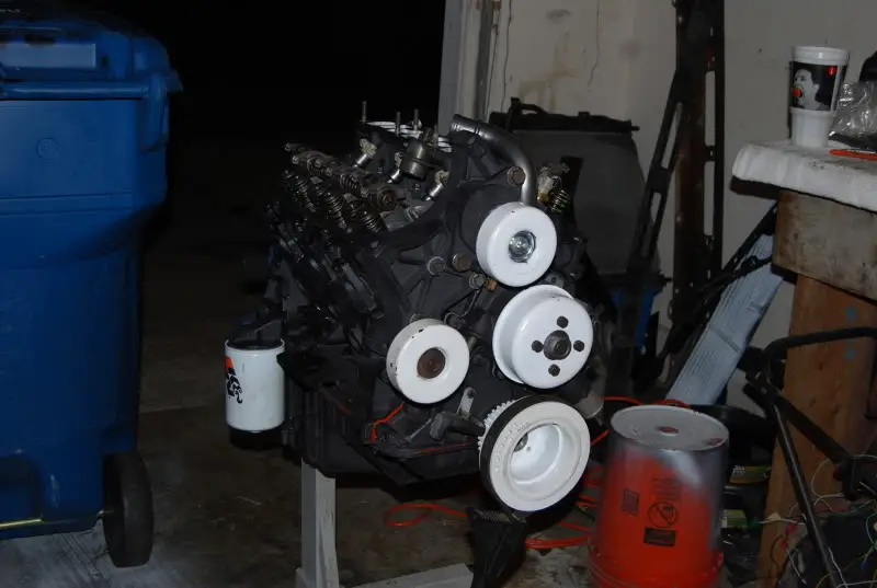

Now, other wierdness I'd like to ask opinions on. All serpintine belt related.
1. Stock sized belt is now too short. Whats with that? A pulley is further away than it used to be before I took the motor apart? How?
2. Chewing up belts. A pulley is not alligned. I think the harmonic balancer pulley is sitting about an 8th of an inch too far away from the motor. The bolt is tight, holding the balancer. Also, the harmonic balancer is seated properly in the key. Thoughts?

The stock belt actually rubs on the spring housing of the tensioner. Its bizarre. I can't see how the accessory mounting brackets would go on any differently.
The brackets really cant move, you probably just routed the belt wrong.
im willing to bet you put the tensioner pulley on backwards if the belt is really too short.
this is how mine looks, and thats how it looked before i tore it apart
Thanks, I'll check that tensioner pulley.
Pulleys look fine. I did manage to tighten the harmonic balancer some more. I'm hoping that I just didnt get it sucked in tight enough. It was hard to tighten up properly as the motor just wants to turn over (Go figure). I held the belt, and tightened as much as possible.

Don't kno what else to say for the belt. That's the only one that could be instaled wrong. Unless its not routed right.
