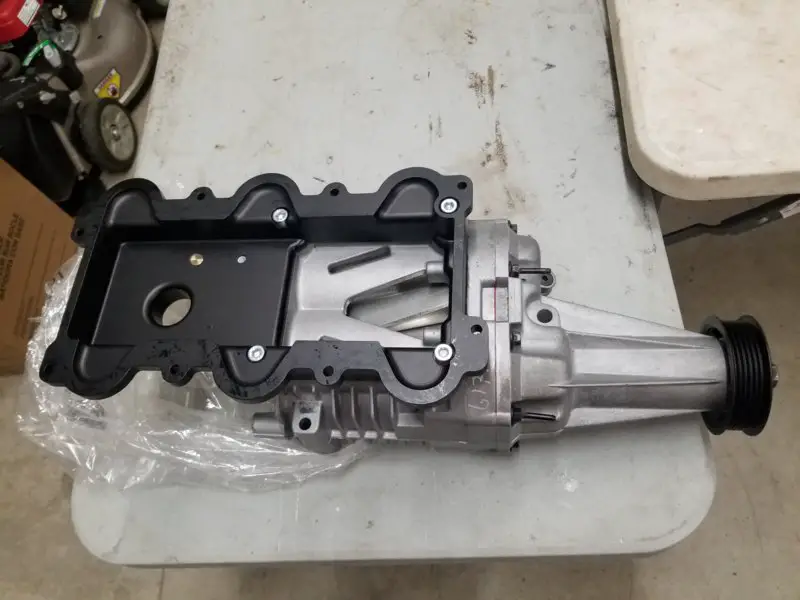

I got the top plate attached to the supercharger and got the pulley installed. I'm hoping to tear the truck apart over the holiday weekend and have a Supercharged Sport Trac by the weekend!
Awwww man that's awesome you definitely gotta keep us updated on that. Would love to see it all finished and see dyno results of that. Enjoy that man.
