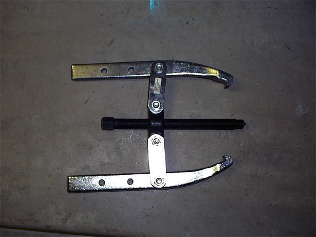

T-bars are cake to remove. All i used was a big 2 jawed gear puller to get them out. I just followed the instructions in my chiltons manual and everything went fine. I removed the t-bars on my old truck and on my new one and no problems.
Here is the puller I use whenever I need to remove my torsion bars:

Yup I used the same thing as robert but mine isnt as shiney :D
