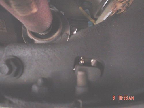

ok i have to go to work in like 45 minutes so i need a pic of the torison bolt real quick like so i can twist it and go. i just put on the 4 door leafs and need to twist them like now!!!!!! please help me!!! thanks

i need to know what they look like. can anyone just go snap a pic of it real quick?

i hate to be picky but that doesnt show me a broad view of the underside. i just need to know what hole there in because i seem to have alot of screws under
there

get under the truck and follow the bar from the front to the end which is right under the floowboard of the front passenger seat. then, there is a bolt right smack in the middle of it. make sure u have the front end jacked up. tht way turning it is easier.
oh...measure so u know how high u had gotten.

Here is the only shot I got. Not a very good one but it will narrow the search down for you. This is a shot where the tortion bolt meets the tortion bar.
