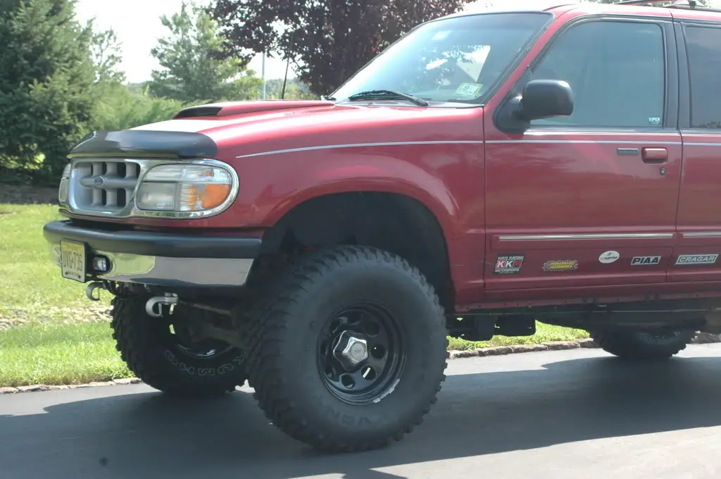

Here's a picture of my tow hooks on my 97, mounted to the bottom of the frame rails in the front and rear. Sorry only 1 photo is re-sized.
why the spacer on the front?...can you get a better pic of the rear?...and where you bolted it, mine doesnt seem to have alot of space int he back.
I used the spacer, if I remember correctly, because the bolts were too long and I couldn't get the nut on inside the frame without the spacers. I don't have any closer pictures of the rear right now and I can't get any for you until later in the week. I basically just drilled through the open part of the frame. The nuts are like right up against the upright part of the L part of the open frame. If you really need detailed pix, shoot me a PM Friday afternoon and I can have them up for you within a few minutes.

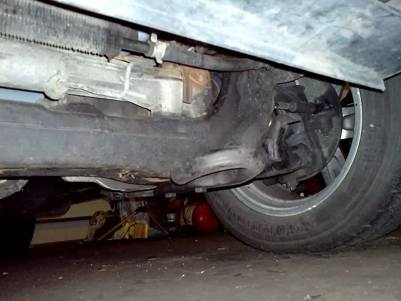

F250? front tow hook
Exploder Sport? rear hook
The bad thing about the sport hook in the above picture is there is no opening to hook a strap up. You'd need a hook on the rope (not recommended) or to double loop the strap through itself. And i hope that a hard tug on the f250 hook doesn't affect the integrity of the crossmember.
i agree 100% sport hooks are only slightly better than nothing :thumbdwn:
Im pretty sure it'll tweak the front cross member or bend the rear loop if anything past pulling it out of a snowbank is required
