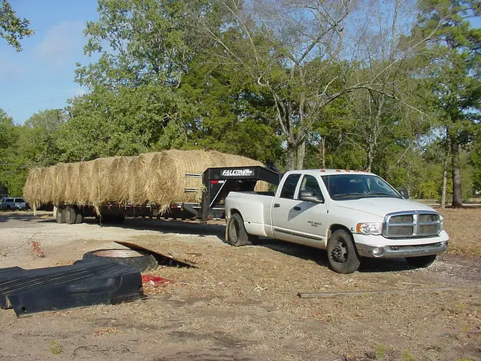

Here's a load of white oak I hauled and yes its heavy.
428534d1433640884-trucked-dead-hauled-hay-anyway-explorer-log-load-jpg
428535d1433640949-trucked-dead-hauled-hay-anyway-explorer-log-load-3-jpg
No issues huh? Guess I shouldn't worry much about towing another Explorer with a dolly. Granted I won't have brakes on it.
Did you get any sweat from the police? I'm looking at 70 miles or so. How far did you tow?
The oak load was less than three miles, but the hay is about 35 miles.

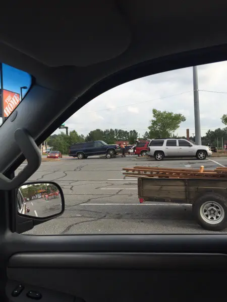

S10 Blazer towing a Suburban. Granted, this individual was a true moonshine making/drinking Southern Backwoods Hillbilly. In context to the conversation, I knew what he was saying when I was talking to him, but he certainly wasn't speaking intelligibly. Lots of 'm' sounds. lol. Nice guy though.
I hate to use this example as reason to feel good about towing another Explorer behind mine, but it's perspective.
Not sure where to start... that S10 Blazer and the Burban.... wow. The 4.3 is stout but that Blazer had to be all over the road.
