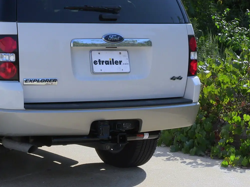

That would be more difficult than just swapping an OE unit. And it would look funny.
Yeah, don't get one of the aftermarket hitches. They hang down really low and don't look right.
Another issue is if the tongue weight is at the maximum back of the Explorer sits down low. It may cause the hitch to drag or keep you from putting the tongue jack down to unhook the trailer.
How is it more difficult? Just bolt and go, 3 of the bolts are already there and only have to fish one.
Looks fine to me, I've seen quite a few like this.
I'm sorry, but that's the stupidest looking thing on an Explorer I've seen. Not only does it not look professional, but it would have taken the same amount of time to just swap OE units.
