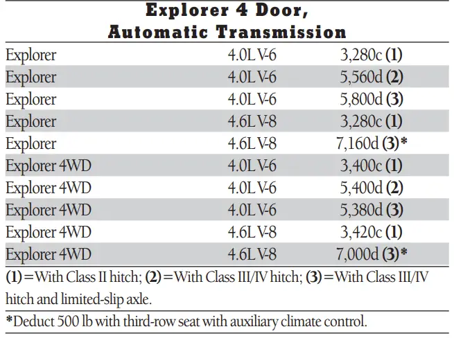

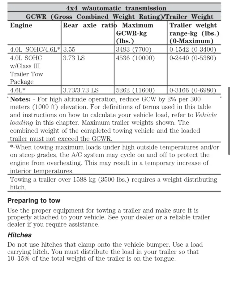

What is the towing capacity of a 2003 Explorer XLT 4WD 4.0 with an open rear differential?
I’m seeing some inconsistent figures likely due to the different configurations.
Thanks!
