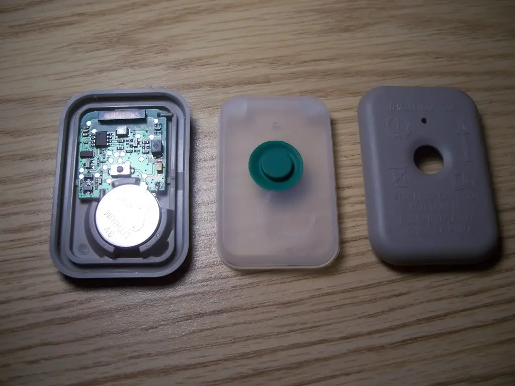

Is there anything battery powered (electronic) on this tool? I wasn't able to find a picture of it.
Yes, it is battery powered:
It looks like the new TPMS systems are more sophisticated than the earlier versions where you only needed a strong magnet to reset everything. I assume that this new version transmits a specific frequency or a code to clear the unit?
From what I've been able to gather and extrapolate from various forums and google searches, I don't know that it is that much more sophisticated. I think that part of the issue is that we don't really know where the sensor actually is. Technically, an installer is supposed to position this sensor 180 degrees from the valve stem, but you never really know. With the type of sensor that gets mounted on the stem, that's a different story and a relatively low-power magnet can generate the field necessary to put the sensor into "identify" mode (so to speak!). If you knew exactly where the banded-type sensor is, it is possible that a strong magnet could trigger the sensor into indentifying itself to the master module... This is all speculation on my part.
Keep in mind that one of the reasons our system is more complex is that is has the ability to tell you which tire is faulty. There are manufacturers that don't go to that level of sophistication: as long the master module gets 4 signals, it gives you a pass. The up side of that approach is that you don't have to retrain the system even if you rotate the tires. In our case, well, we're kind of screwed...
