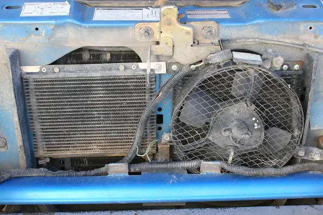

Here is what we did for our 1st gen X. Thats a pair of stacked plate coolers and a 10" pusher fan from a geo Prism/toyota Corolla (1991 iirc).
Transmission-cooler-misc 003 by maniak_az, on Flickr

I don't think you could fit that on in the front of the X but they do make smaller ones too. More selection @ bulkpart.
Also, as mentioned.. Get a temp gauge on there so you have a baseline. That way when you add the coolers you have something to compare it to.

I think my x has a better set up for 2 smaller coolers. Heard anything good about b&m stacked coolers?
maniak did you get better performance from 2 smaller or one big cooler?
B&M is a well known company for transmission, accessories and coolers. I haven't heard anything bad about their coolers but I think they are over priced. Tru cool coolers seem to be better priced and they offer bigger ones.
As for a big single or two smaller coolers. I can't really say what works better. In my case they were installed on different vehicles with different transmissions and different space requirements.
I can say that the big tru cool in the pic above is close to the same frontal area as the twin coolers in the explorer cooler pic above BUT the big one is also twice as thick which gives it roughly 50% more cooling capacity.
