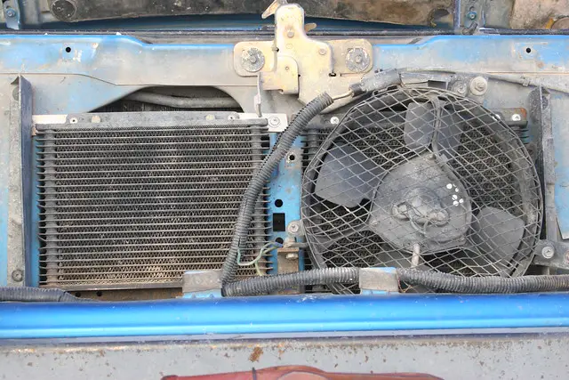

Just in case it helps.... Here is a shot of our trans cooler setup (with the aux fan).
Transmission-cooler-misc 005 by maniak_az, on Flickr
The aux fan is off a 91 Geo Prism (Toyota Corolla).
