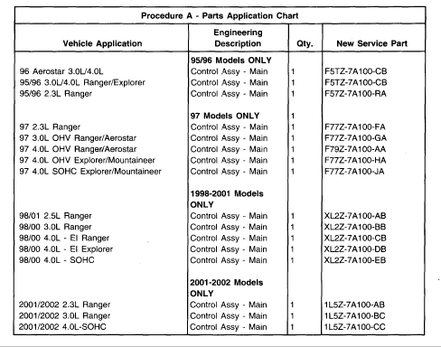

Procedure A:
1.If major contamination is present, follow normal Workshop Manual procedures to repair internal transmission damage. If the transmission is repaired remember that the the Main Control (7A100), Fluid Pan Gasket (7A191) and Fluid Filter (7A098) must be replaced. Refer to the application chart for the correct Main Control assembly to use.

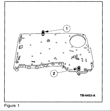

Procedure B:
CAUTION A NEW SEPARATOR PLATE 7A008 OR 7Z490 MUST BE USED WHEN INSTALLING THE SPECIAL SERVICE KIT 7M203 OR ADDITIONAL TRANSMISSION DAMAGE MAY OCCUR.
1.To UPDATE the main control to the new level, follow the steps listed in the Service Kit 1L5Z-7M203-JA (ALL KIT CONTENTS MUST BE USED). A new separator plate (7A008 or 7Z490), upper/lower separator plate gaskets (7C155 and 7D100 used only with a 7A008 plate), fluid pan gasket (7A191), and a fluid filter (7A098) must be used. ALL NEW PARTS MUST BE USED. Refer to Parts Application Chart for parts selection.
2.Install the Special Service Tools 307-333 and 307-334 (1 each) onto the main control (Figure 1).
3.Install a new service Separator Plate (refer to chart), make sure that the new plate has hole # 50 deleted, install the three (3) screw and tighten to 7 N.m (62 Lb-in).
4.Install a new separator plate to case gasket (7C155) if installing the 7A008 style separator plate. DO NOT INSTALL a 7C155 GASKET IF USING A 7Z490 Separator Plate.
5.Remove the special service tools.
6.Continue to follow the assembly steps as found in the assembly of sub-assembled, main control valve body.
7.Reinstall the main control by continuing to follow the Installation steps listed in the Workshop Manual, In-Vehicle Service, Fluid Pan And Gasket Procedure.
Chart for Procedure A

Figure 1 for Procedure B

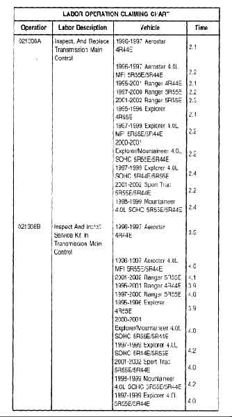

Labor Chart for TSB
