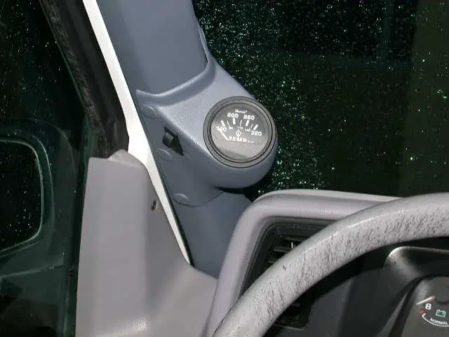

Glacier, this is the Autometer 15309 for a Ranger from Summit, $21.95. The fit isn't perfect but pretty close;

I assume the rocker switch is for night illumination.....?

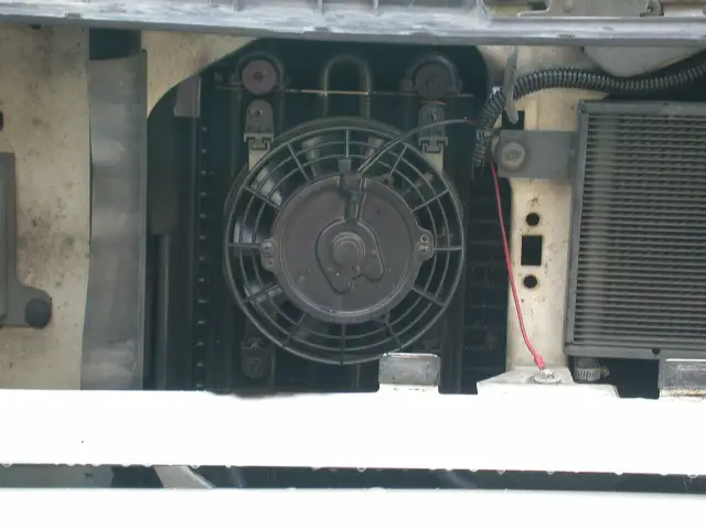

No, it turns on the fan on the SECOND auxillary cooler for towing our boat at slow speeds. I re-painted it and it matches the rest of the interior much better.
