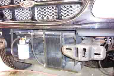

I mounted mine in the mounting assembly for my remote tranny filter; works great.
anyone else??/ i'm curious if i could just take my trans pan to my transmission builder and see if he can put in a bung for me to screw into. i'm gonna get going on this project sometime this weekend when i go home. i know i've seen recently where someone put a gauge into the lines though. i'm in need of an idea as to where you bought the fitting to screw the the sender into.??
Perma-Cool makes a very nice filter guage combo.
You can't go wrong with an additional filter.
The temp send goes in the filter mount.
I got a high pressure T and cut the high pressure lines in half near the Trans. I then hooked the ends together with steel braided fuel hose, and then installed the temp sender to the T. You can use regular fuel hose if you want. The temp on the aftermarket gauge shows the same temp as it reads on my OBDII scanner. I also have the Perma-Cool filter and feel it's definitely worth the money.
