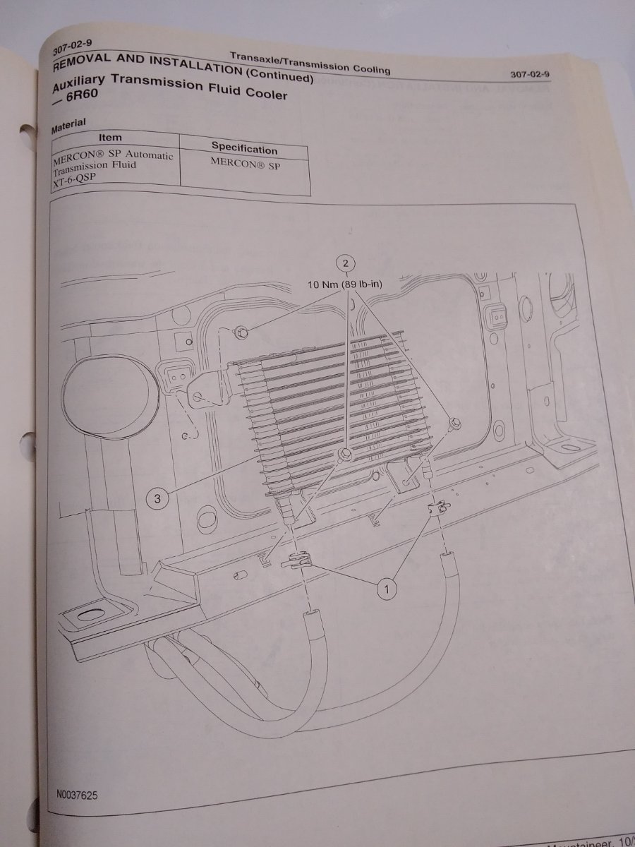

You sure your Limited doesn't have an aux cooler? Thought all tow packages had one. Mine does.
If you have a big hitch, aux cooler should be there. All part of the package.
I've seen 205 plus in stop and go traffic. Cools down once moving. So I would say you are seeing normal operating temps. Mukaloco recommends fluid change every 30 to 50k.

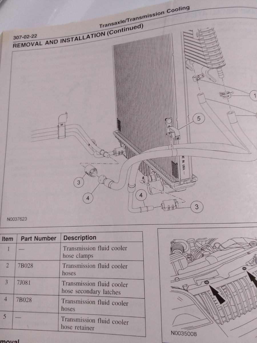

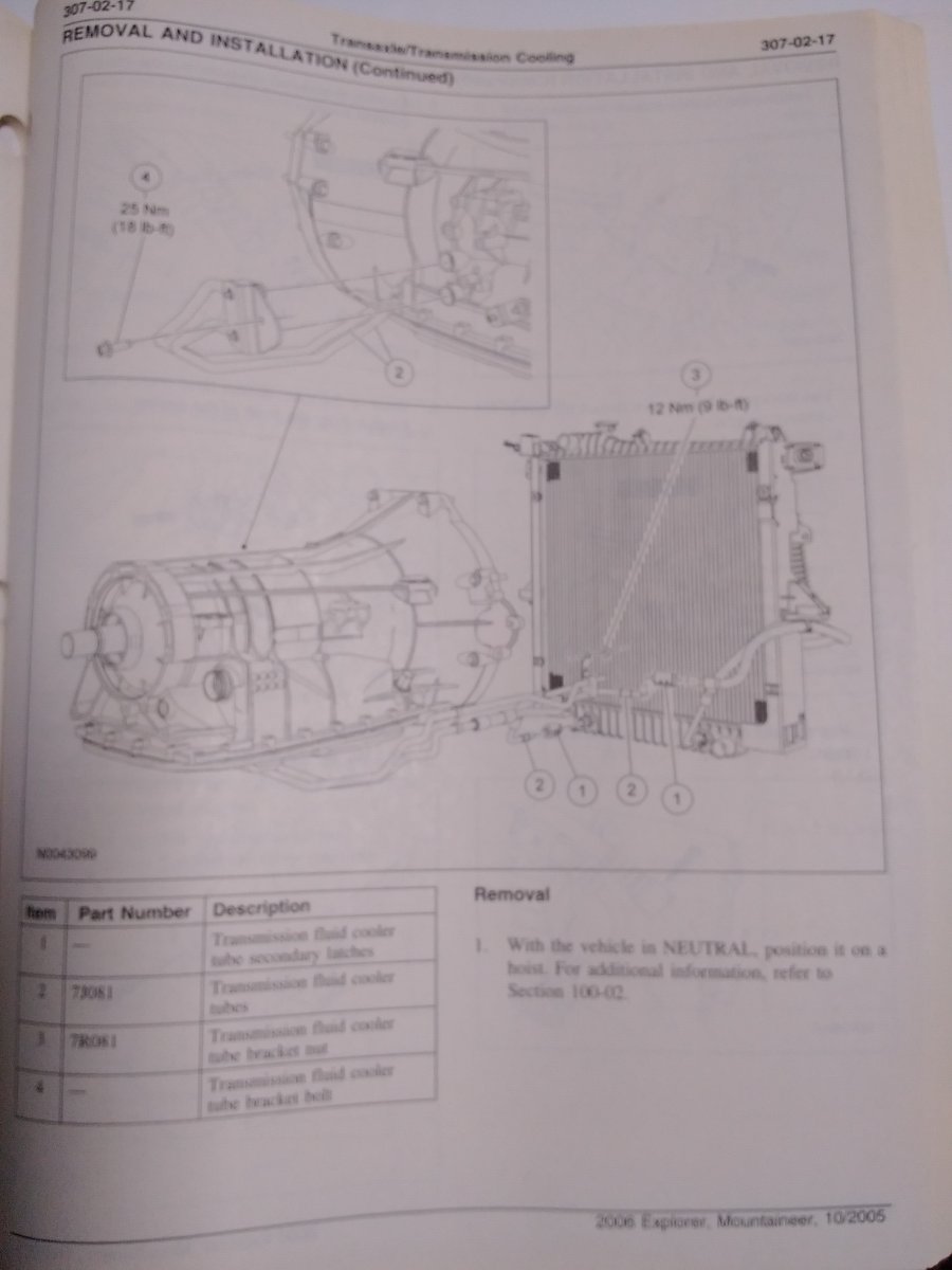

Bill, thanks for that. I'll double check for that aux cooler. Is it located in front of the radiator? I know there's a cooler located just below the radiator but always though that was for the power steering.
It def. has the tow package. Wiring for the trailer looks to be all factory; both a 7 pin round plug and a flat four. I seem to remember checking the door label but I'll have to look again.
Check here.
