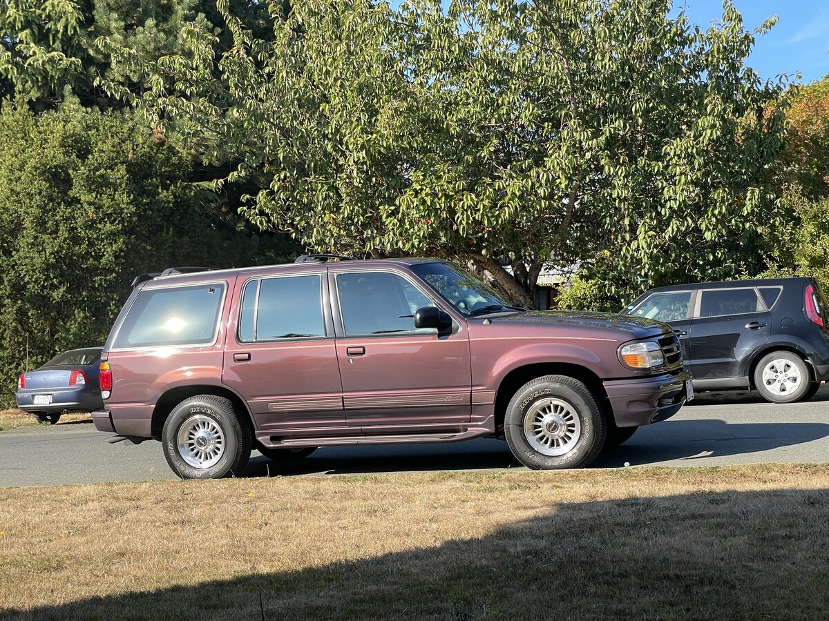

Hello!
I just acquired a 97 Ford explore limited 4.0 V6 with control Trac four-wheel-drive. It has 124000 Original kilometers. I brought it to my mechanic to have it looked over, specifically because the transmission is shifting rough between gears two and three, and also shifting rough when it is down gearing as I come to a stop. All of the 4 Wheel Dr. modes work very well.
My mechanic has recommended a transmission fluid flush and also that adjustments be made to the transmission bands from a local transmission repair specialist.
Wondering if “band adjustments “is a different way of saying “rebuild the transmission? “
Anyone else had experience with this? What was involved and how much could I expect to pay?
Thanks for any insight you have!
