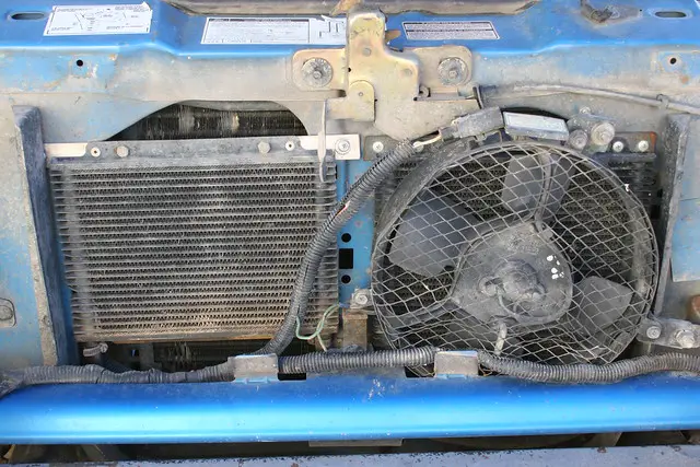

As long as you run the fluid through both the coolers AND the heat exchanger in the radiator you should be fine. The heat exchanger not only cools, but warms the fluid in winter.
You can fit 2 coolers up there but you may have to make your own mount. I'm running 2 coolers AND I put in a fan out of a Geo Prism (Toyota Corolla) that runs when the transmission is not in lockup.
Transmission-cooler-misc 003 by maniak_az, on Flickr
If you did find your transmission was over cooling (not likely) you can get bypass valves that will keep the fluid from going into the 2nd cooler until it is warmed up.
Another upgrade to the transmission is to put in an external filter. Basically, it's a remote oil filter mount (used the same filter as your engine) and you plumb it inline with your cooler lines. I change mine every 2 oil changes. This filter is much more fine than the screen in the pan and you are replacing 1 quart every time you change the filter.
