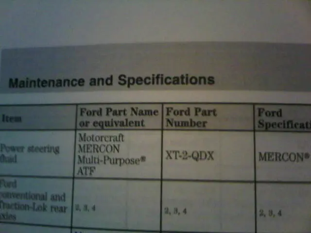

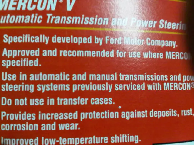

turkey basting the power steering with the remainder??? i hope you dont plan to put the 6th quart of trans fluid into your power steering? if you do you can and probably will break your power steering system. power steering has its own fluid its clear and somewhere between the consistency of brake fluid and trans fluid. go to the auto store and find power steering fluid.
i stand corrected... sorry im old school a bit. the trac is my first 00+ vehicle all vehicle prior to my trac used power steering fluid to include my 04 sunfire so i apoligize
