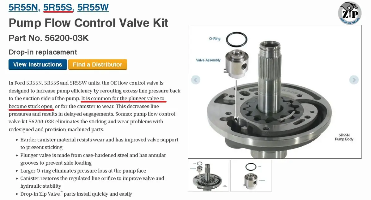

Common issue is the pressure relief valve in the front pump.
Some times the 5R55S has a problem with the overdrive sprag one way bearing.
And it has always problems with worn out servo bores.
Maybe the solenoid pack makes trouble,
so i think not only a valve body change would fix your problem.
Sorry for the bad news, hope you will find a good tranny repair shop.
