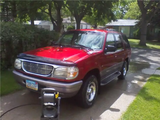

I'm a 20 year old girl that absolutely loves her Mountaineer. Haven't had any problems with it, and I just got over 100,000 miles on it. Some purists might look at my car odd cause he had a collision with a deer, what caused the other side to look bad, and ruin the grille. But Trevor's gotten me through knocked down bean fields, so I'm not complaining. Most recently I've had to get the front wheel bearing fixed. (http://www.explorerforum.com/forums/showthread.php?p=1499806 Thanks to this guy, or I would've had to spend alot more.)
The only problem that the car has is when you try to turn the wheel more than 45 degrees you have to hit the gas to make the car go. So not much to complain about. My father bought the car used in 2002-ish for a little over $10,000 and only drove it to work and back. Even at 17mpg I dont understand how one can do that with such a wonderful car.
