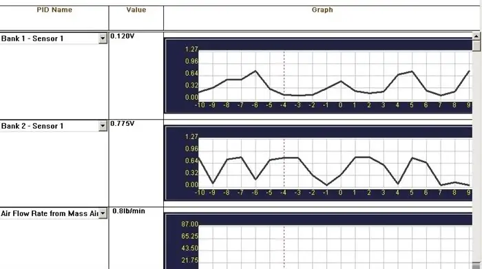

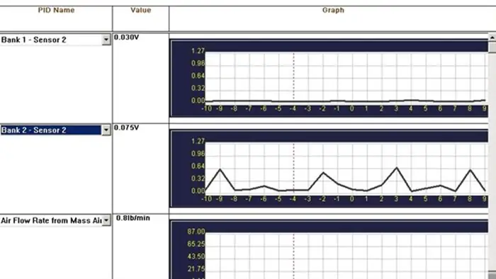

Live data by frames on bottom of graph
Bank 1&2-sensor1 voltage
Bank 1&2 sensor 2 voltage
I am not sure what the difference is with the sensor 2 set
Bank 1 sensor 2 looks like a dead channel?
Maybe it's supposed to look like that, I don't have access to what normal readings are supposed to look like.
I've recently cleaned the MAF and IAC, and replaced the PCV. Plugs have not been changed by me and I don't know when they were changed last.
It's next on the list and then wires, mileage is about 10 around town.
I haven't had the vehicle very long, and I've just been going through stuff as I find it along with some PMs.
At any rate maybe someone can help me out here and tell me what I'm seeing. I sure would appreciate it.

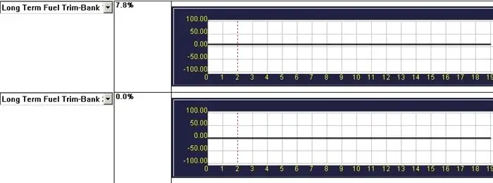

Also looked at fuel trim whatever that is
Long Term Fuel Trim Bank 1 on top bank 2 below
I did pick up some plugs, Motorcraft SP432 finewire platinum.
I'll be replacing them shortly and take another data set for comparison.
ETA: Plugs replaced. Old ones were pretty clean on the porcelain but were worn with minor anode/cathode deposits. No new data as drive cycles have not been completed to clear P1000 code (and why did it start coming in?).
