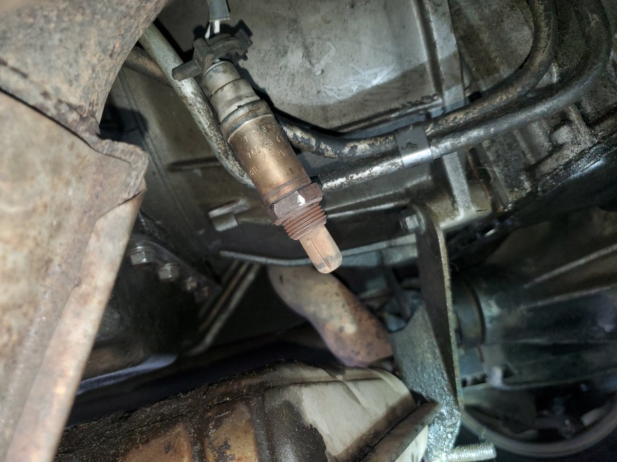

You can pull the O2 sensors to test that theory. It will run in open loop, but the O2 ports create a spot to relieve back pressure without having to drill holes.
Hey I ran it for a few minutes w out the upstream 02 sensors. Is that bad?
I like how it sounded on start up. Real mean like a Harley.
Did it change how it ran or idled?
w/o them in there it seemed to run "rich" and like it would almost die every 2 or 3 seconds, and then it would rev itself back up again.
Def idles better with them in there.

If they’re original, replace them. People will say to not change them until they throw a code, but if those sensors are 26+ years old, and you have them out, install new ones. They’ll have better response anyway. Consider it preventative mx.
