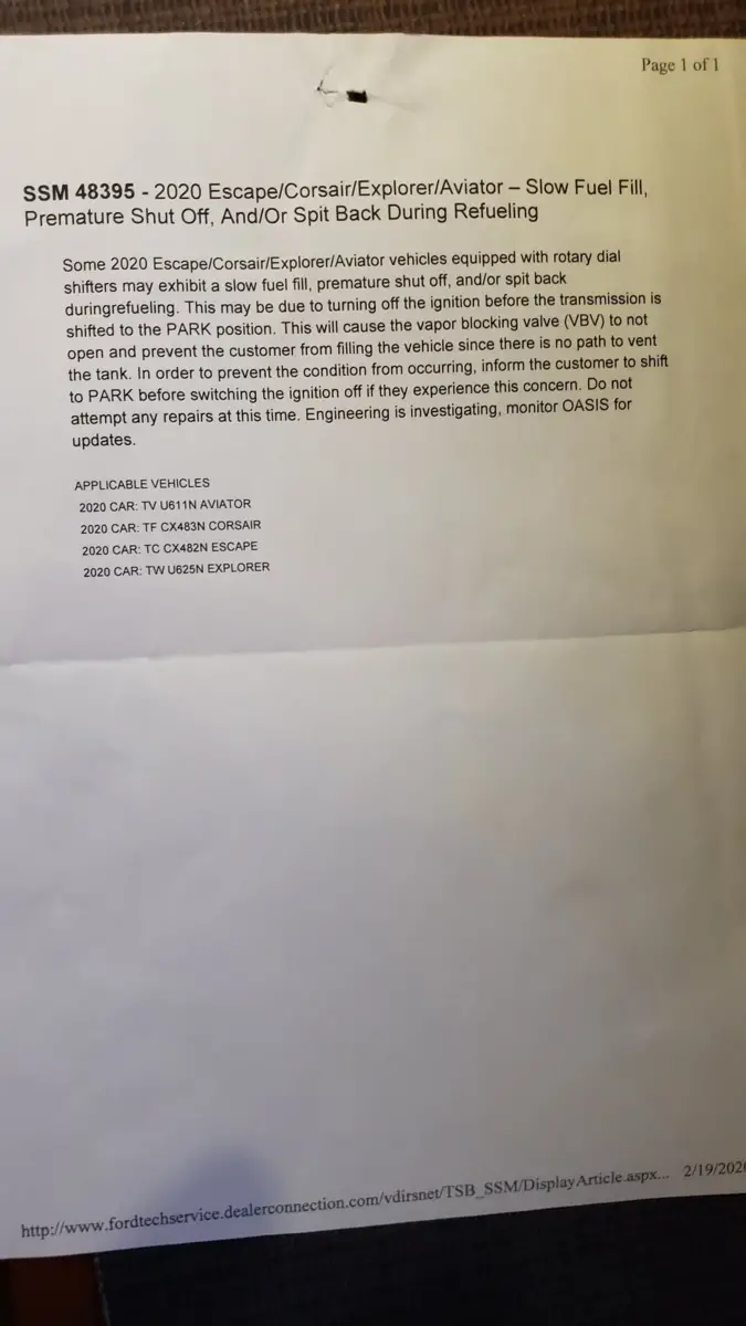

I just had this (gas pump click stop) happen to me last Saturday. On Sunday evening, the check engine light lit up and Ford Pass said there was an issue with evaporative emission system. Went to dealer on Tuesday and they got the code from the scanner. They had to overnight a part to replace to try to diagnose the issue. They replaced the part the next day but when they did a test gas fill, same problem. Tech checked everything on the fuel system and did a smoke test, everything passed. Eventually they ordered a new fill valve and replaced that today, and the gas fill finally didn’t click off. $17 charge for the gas, everything else was covered under emissions warranty.
Here are the details from my write up
WOW, that's a lot of work, did it say how many hours involved?
I added this one to my list of things while the dealer has it. I'd forgotten about it, as it had become habit to back the nozzle out an inch or so before filling to get a full tank without interruption.
I would guess 12-14 hours. Dealer had my car for about two days - I brought it in on Tuesday morning around 10am, service advisor said they had to wait for a part and asked if they could keep the vehicle overnight. I needed to get home and they didn’t have a loaner, so I got my car back around 3pm and dropped it back off on Wednesday morning at 8am. Service advisor called at around 11am and said they replaced the first part but gas still clicks off, and they need to order another part. But this time they had a loaner for me, so they kept it overnight. Finally on Thursday around 3pm, I saw on the FordPass app that the service condition was green and my service advisor called to let me know the car was fixed and ready!
