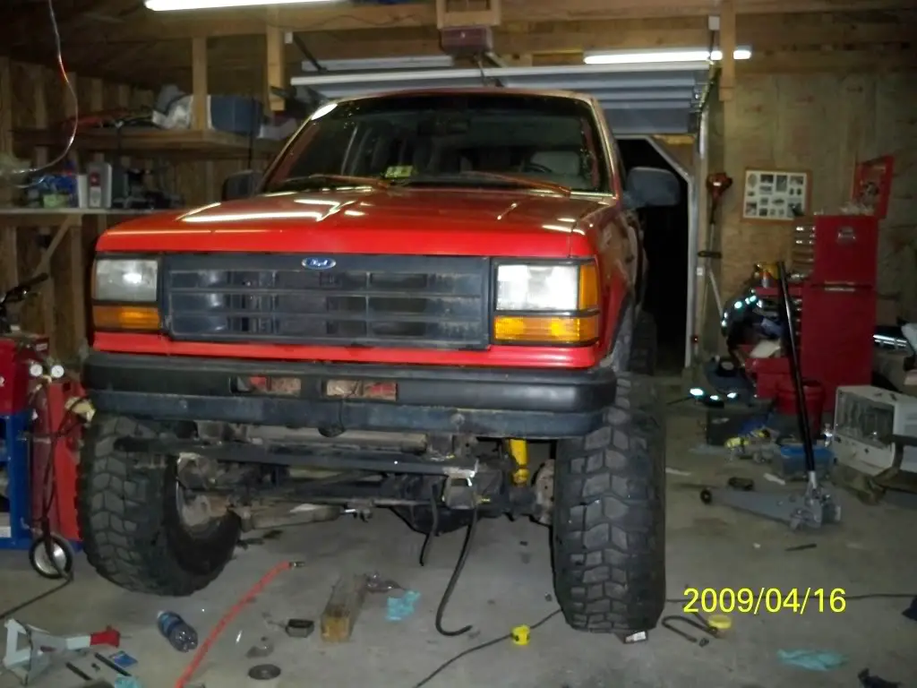

first thing that comes to mind is the absence of a drop pitman arm, also them tires look real wide at the front, might need a toe adjustment ,
