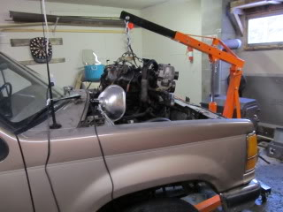

update - should have replace ALL the lifters.... noisy doesn't begin to describe it, better but still horrible.

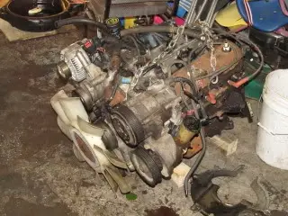

Found a used engine on craigslist for $200... I figured why not. This was my New Years Eve project.
out she goes
in with the new (used)
