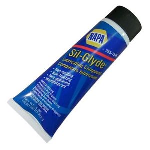

While we're on the topic, what's the suggested lubricant for the slide pins?

..to answer the question of the lubricant on the slide pins.. Sil-Glyde.
