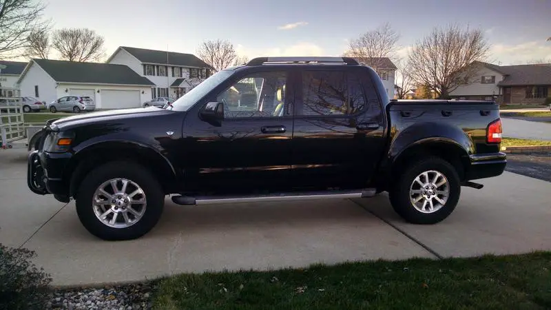

Here are pictures of with the Truxxx lift installed.

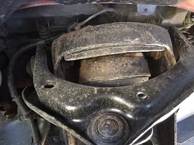

I have the feeling mine has the Truxxx leveling kit installed - I can feel 'between' the top cup and the body. Here is a pic in the front. My current tires are 265/65-18. I'm considering dropping them to 255/60-18. You can see the top of the cup for the spring...
