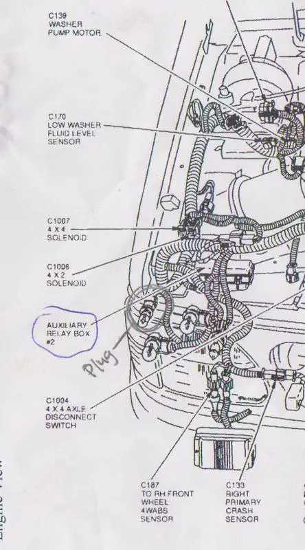

One, what is the spring button on the passenger side wall in the engine compartment that makes contact with the hood closed? I thought it was for the light to see the engine but when I start to close the hood the light goes off without even touching the switch. Two, front right marker light dead. Change bulbs, check fuses, nothing. All other lights work. I did notice two things. The owners before rewired the headlight over on that side and there is a plug that has two red wires attached that goes to nothing coming off another plug... See Picture...

The spring button is for the vehicle antitheft. If someone rewired things, it could be anything. I would unwrap the harness there and see what you have. Where did you get the drawing, what book/manual? It shows 4x4 solenoids I did not know about.
That answers one question! Thanks yavapaires! I attached the full diagram for you. I got it from the Ford dealership for free!
