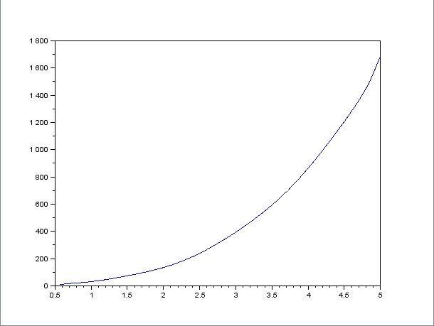

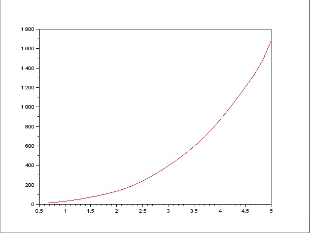

LMAF MTFs
I input the PMAS and measured LMAF MTF data into Scilab and plotted them. I omitted the 16 volt point to avoid decreased resolution.
PMAS:
Measured:

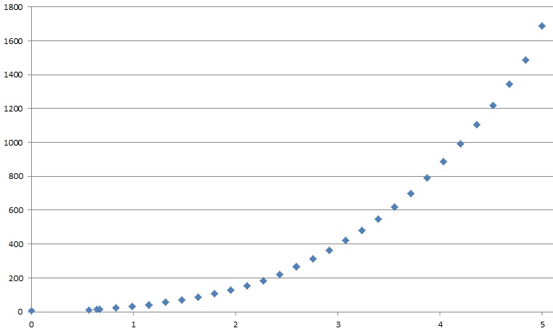

I used Scilab because the data points are different and Scilab is supposed to be able to plot two matrices on the same page. But so far I've only been able to plot one matrix on a page. I'll try Excel next to compare the two MTFs. I wasn't able to make two plots on a page using Excel so I just entered all of the data and did a scatter plot.
Except for the two lowest values in both MTFs it appears the difference between the two MTFs is less than the size of the diamonds.
