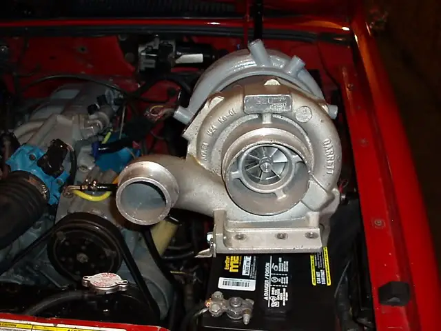

I thought id atleast put my turbo ontop of my battery so there are no doubts weither I am actualy turbocharging my explorer.
