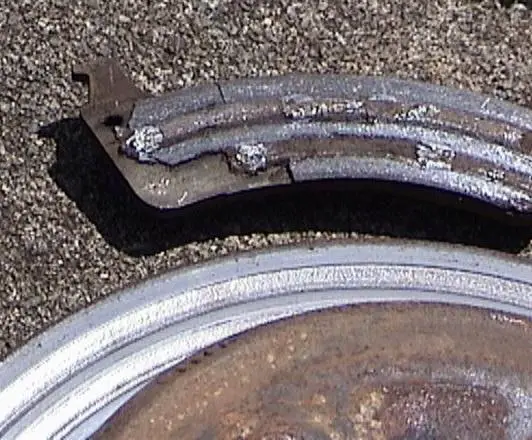

Here is a pic of my gouging.

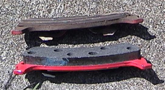

Old pad vs. New pad

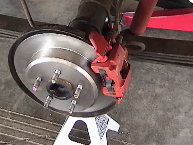

Finished product

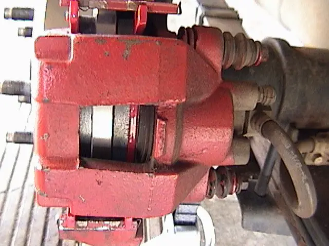

Side view
