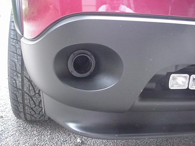

Secret heat dissapating system:)
BeauJ said:
I love that reflection Spindle, you look like grandfather time.
Indeed beau I do, this site has aged me terribly :D
