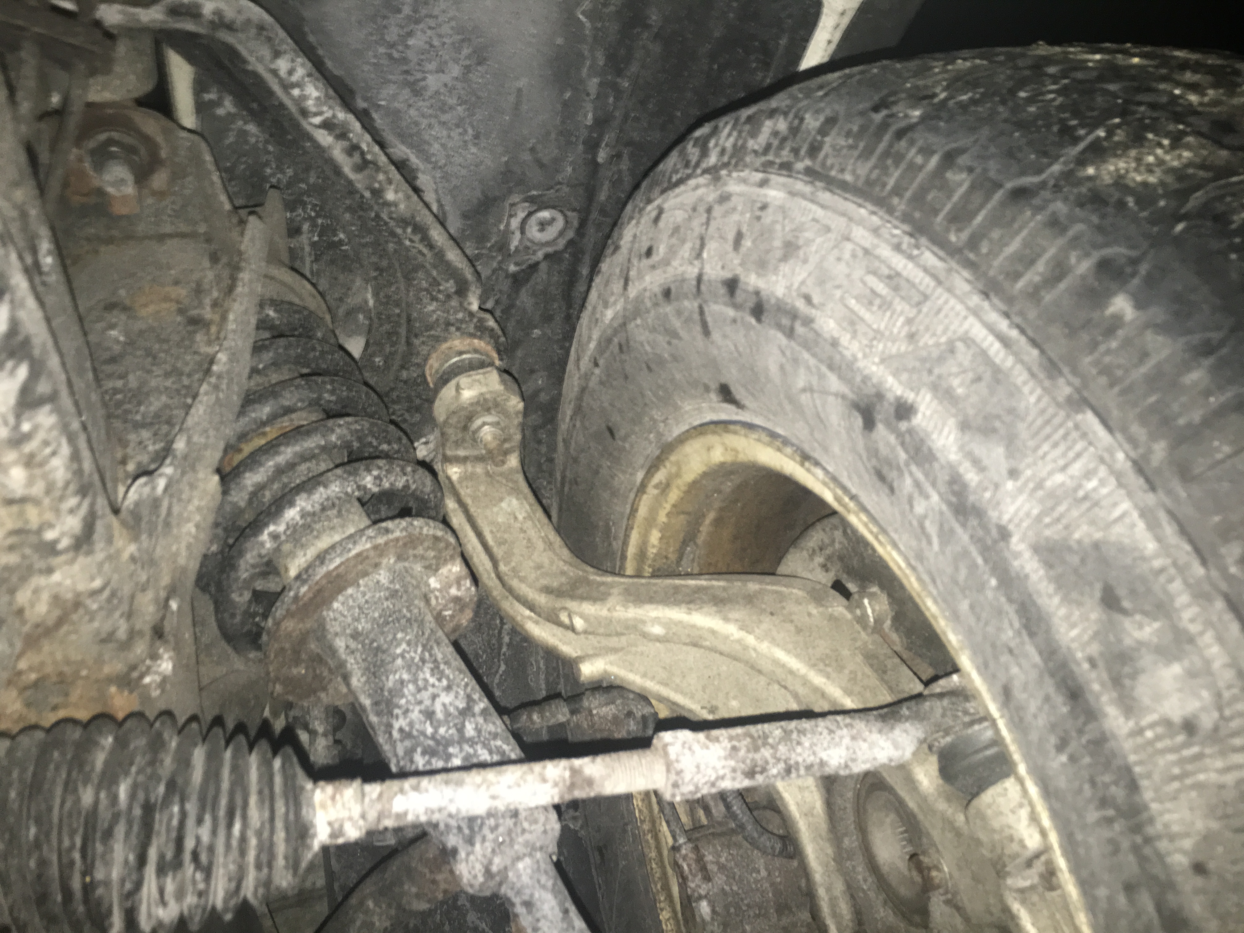

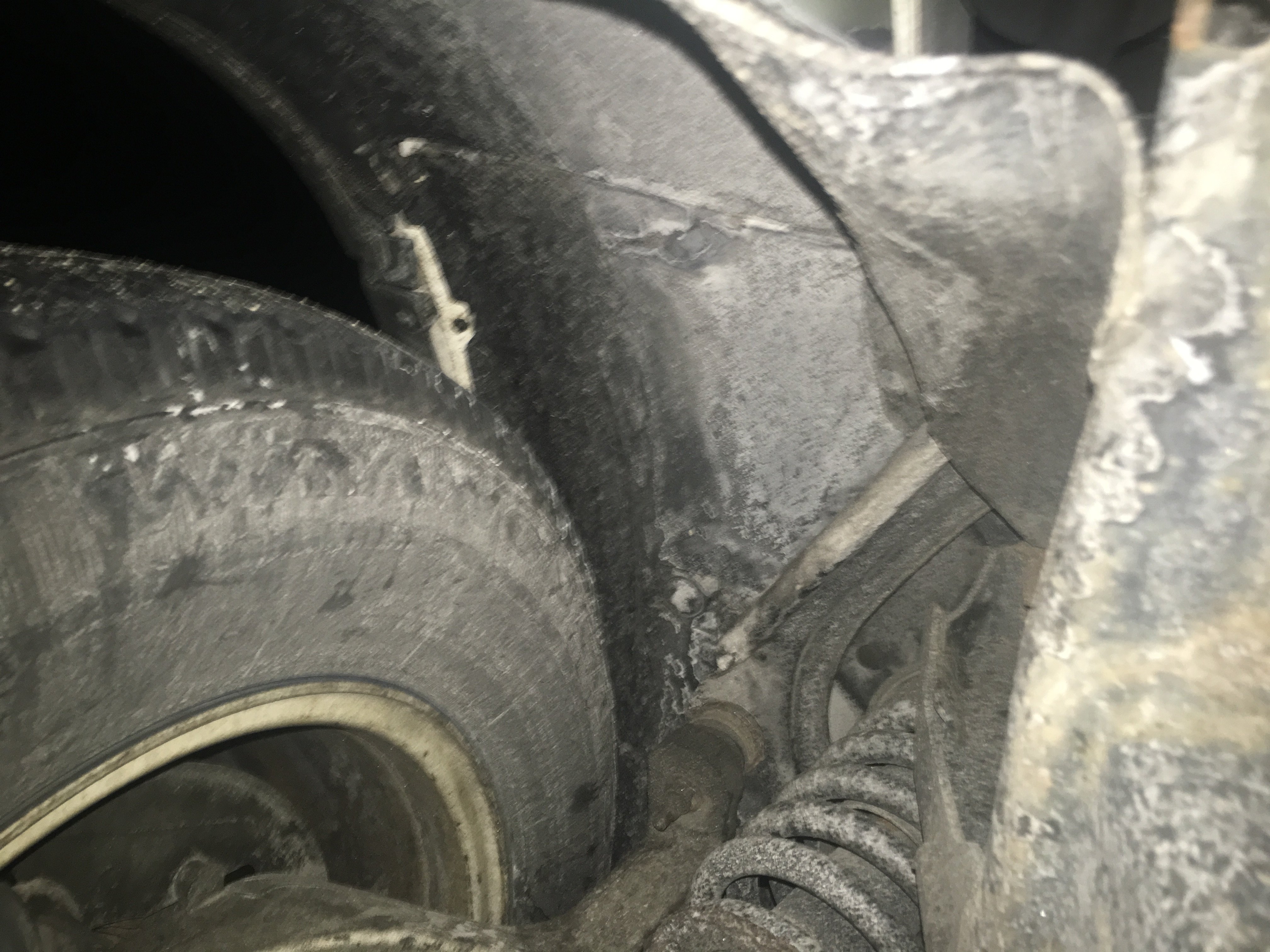

About to get the passenger side upper control arm and ball joint done this weekend. I had the driver’s side done already.
The truck has not been washed but I took some pics to try and see a difference between the two. Hopefully it is noticeable with the dirty truck:
The first pic is the one that needs replaced.

Very nice always good to do some service yourself if you can and save a buck, how much has it costed you to do this with both UCA's?
I recently opted to just replace upper ball joints (boots on old ones are all torn up). Truck handles fine, so I'm waiting for warm weather. Found two closeout Mavotech Supremes ball joints on ebay good price. I think the lower ball joints are higher weight/stress parts, do feel okay with Chinese stuff for top.
I paid $189 per side.
