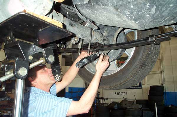

I have a set of 3" drop leaf springs. We put some on a Sport Track and it dropped 4.5'. The ride was very stiff though. It could be a good match for your set up.

Here is a picture of the leaf springs that I was telling you about.
